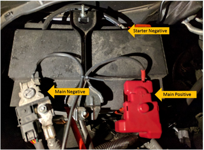

Thought I posted this yesterday but I guess it didn't go through..
My ESC stopped working a few days ago. Short version: looked at the wiring and found this (see pics). The blue and black wires leading to the ESC were singed together.
Has anyone seen this before? Any ideas as to the root cause? And what is the remedy? Can I just clean the connector ends with a file and reconnect? or Is the esc toast? How do i test if the unit is OK?
Much appreciate any ideas.. Life without boost just isn't the same
you posted it in the owners thread: http://www.ft86club.com/forums/showt...=66862&page=83
you have replies on that page.
If they were "singed together" I have to stand by my oppinion that they were vibrating or rubbing against eachother untill they wore through the insulation, causing them to arch. If it was corrosion as Ultramaroon suggested, the red wire should show some signs of contamination as it right next to the other two, and so should be exposed to the same conditions.
The system should not be damaged, so you can try to wirebrush those contacts, and put some new heatshrink insulation on them, but it looks like the plating is gone, so it may not be a very tight fit. You can replace those connectors, I have seen them on Amazon but cant remember the source, I'll try to see if mine has any markings, or Email Rob and he may help with that.
I have not heard of this happening before, but If i am right, it could be solved with wire spacers, something home made like this [ame="https://www.youtube.com/watch?v=Fll_OPtYsJE"]https://www.youtube.com/watch?v=Fll_OPtYsJE[/ame]
or what I did was to slip that plastic wire loom over the connectors which keeps them tight together, and wrap it with some electrical tape
This looks like a similar type of connector if you want to change it: https://www.amazon.com/s/ref=nb_sb_n...llet+connector

I've had this happen a couple years ago. It happened when the cable's were too tight, i had a hard shift and the engine moving caused the wires to disconnect and arc. Mine wasnt nearly as bad as your's but we were able to clean them.
Also if they do rub together for long enough the same thing can happen.
sounds like a spacer might be a good way to go just for safety. It sounds like it would be a better design choice to replace the 3 bullet connectors with one single indexed plug, but would probably lead to a price increase.

Had the same issue some time ago, figured loose connectors was the issue.
Cleaned connectors and added a small hard plastic cylinder to the centre of the male connector to keep it expanded. No issues since.
Will be doing the cable tie separator just incase.
Same here. Cheap and effective

I am happy to announce boost is back! Thank you gentlemen and have an awesome Canada Day :-)
