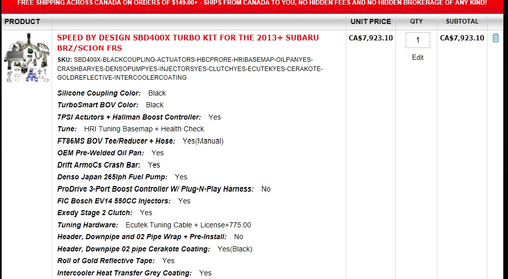

The SBD turbo kit with most of the supporting mods (fuel pump, clutch and injectors), comes in at $8000CAD. There a few other things that are needed/suggested. One being the STI PCV valve (metal vs our plastic) and an oil cooler. Then factor in another 1000-1500 (just guessing 10-15 hours at 100/hr) for install and you are sitting in at close to 10000CAD (7500USD).
