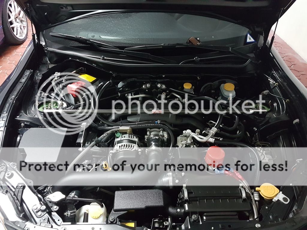

Quick question from a lurker, what oil coolers are you guys using if any? Any other cooling modifications?
I have the AVO oil cooler kit. Good placement and works for me even when I go to the track.
This is part of the reason why I like the AVO kit. If a cop popped this hood, he'd think it was bone stock apart from the braided oil lines.
