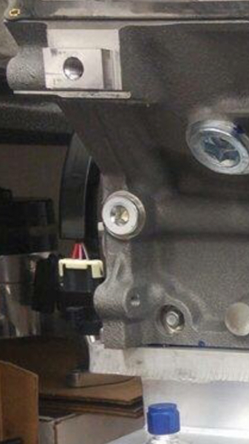

Looks good!
If you're willing to consider my advice, don't use this oil pressure port for your feed (left). Cap it off.

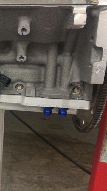

Instead, use this pressure port as your feed (front left of motor).

Once you have the motor installed in the car, you will find the clearance between pan and steering rack is inadequate to fit a proper -10 oil fitting for your oil feed. There is however (barely) enough room to fit the return fitting.
Best of luck to you, this build looks promising.

Originally Posted by Amir Ghadiri View Post
Looks good!
Attachment 131433
Attachment 131434
That helps a bunch. Thank you @Amir Ghadiri
