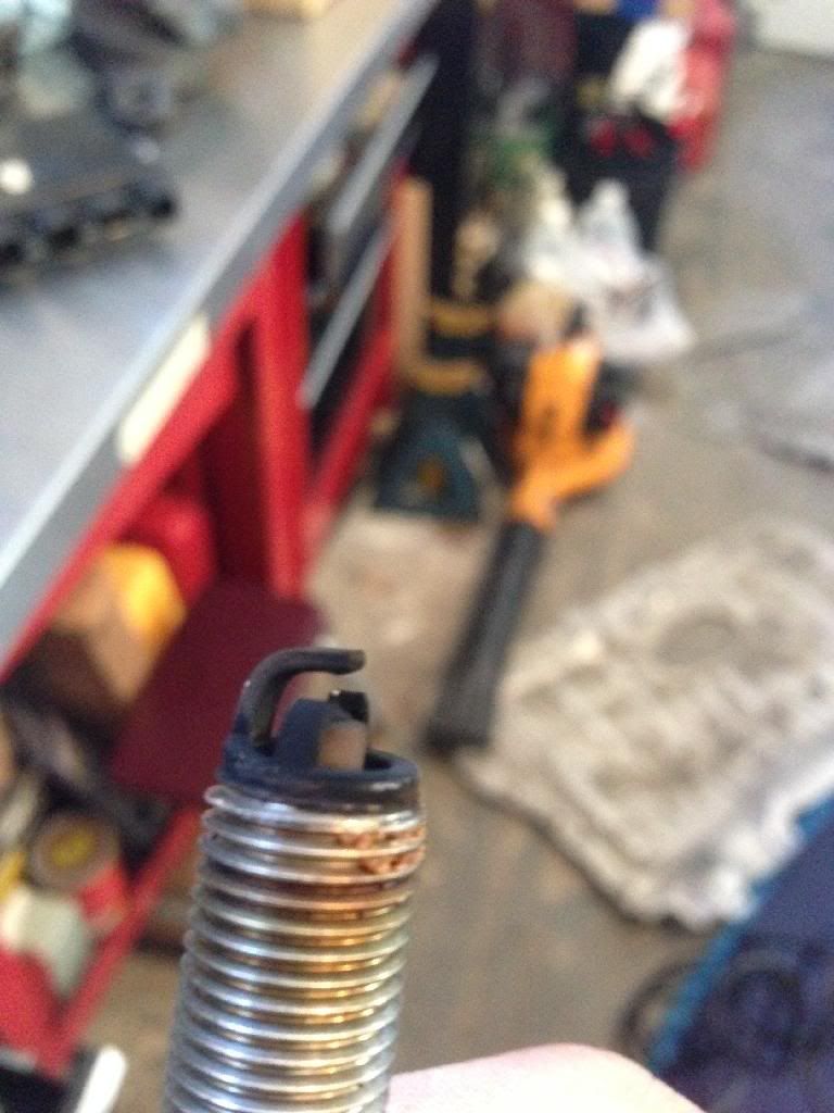

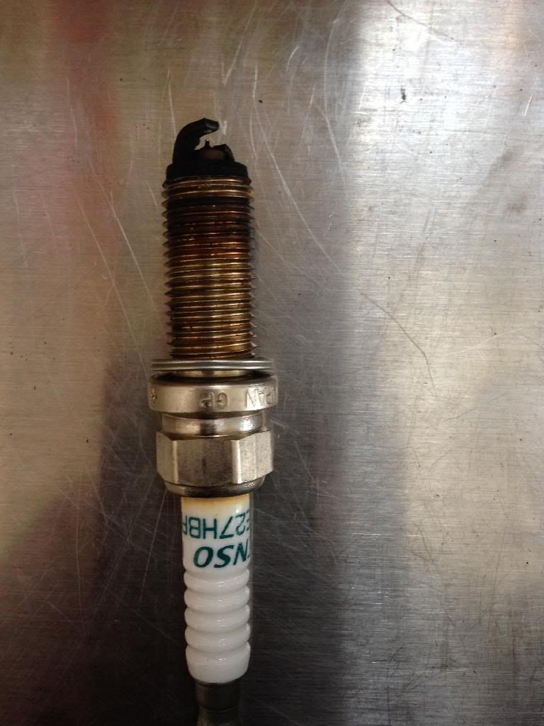

Plugs were easy to get to once the motor was jacked up. You have to remove the ICM on the passenger side (well you don't but it makes it easier), and I took the injector cover off the driver side to get to those packs. The driver side sucks because of the fuel lines. My hands are pretty cut up from all the **** over there but swapping the plugs was pretty simple.
Stock plugs:

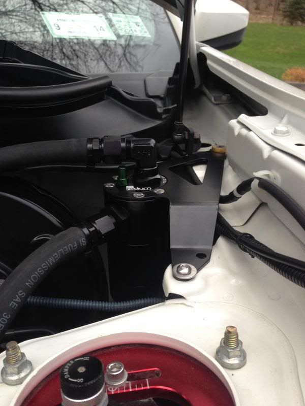

Pic of the Radium can:
xxscaxx is offline   Reply With Quote

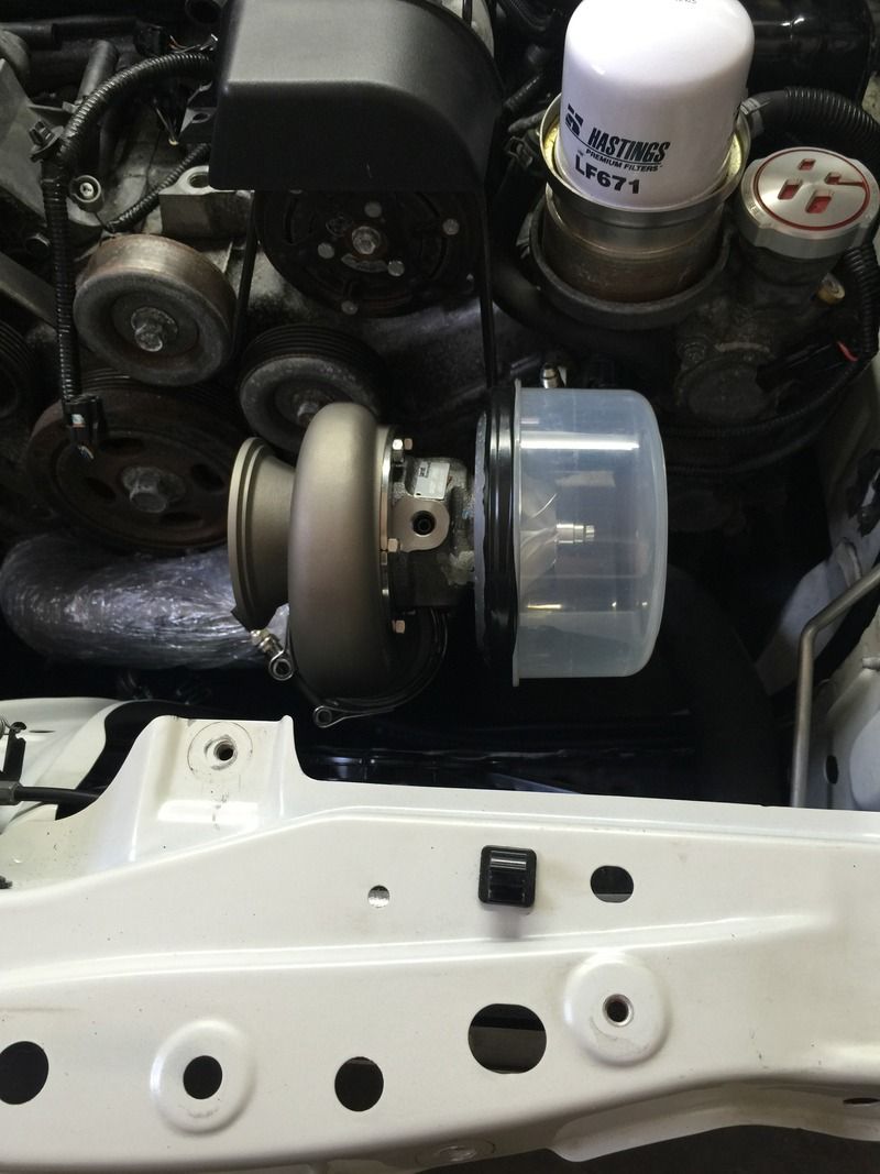

My Makeshift compressor housing until mine comes back from chroming

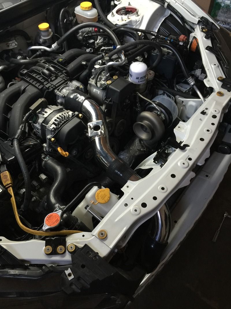

Laying in the IC pipe to check fitment and see how it looks.
