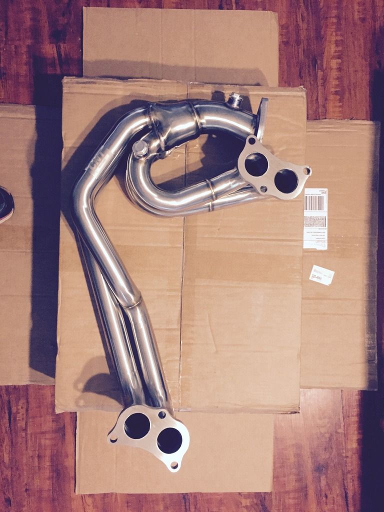

I got mine today, it looks to be the same quality as everyone else. My only complaint is the packaging, there was not bubble wrap or anything just the header, a plastic bag over it and a box.
I will be test fitting tonight, and if all is well i will ceramic coat it and then do the full install. I will keep you guys updated on how it goes.

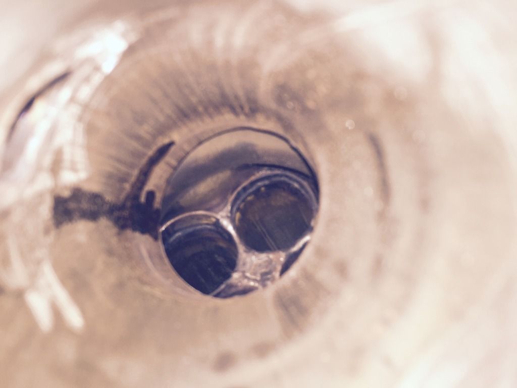

Installed mine yesterday. I have to say, I used to work at a architectural metal shop and the weld were nice considering. When I looked at some of the more expensive headers I was not impressed with the welds. Yes, the collector could use some reworking on the inside, but it's what I could afford. Sound is amazing
