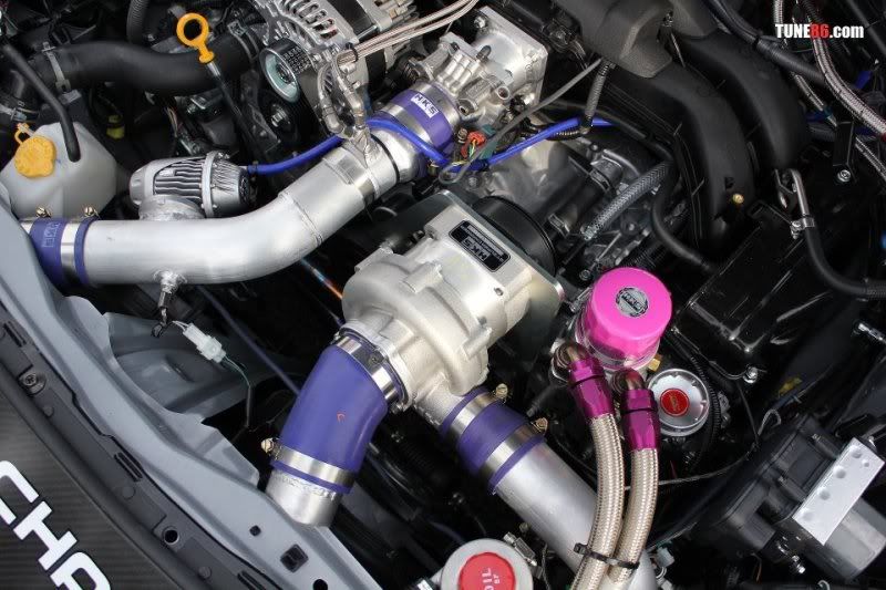

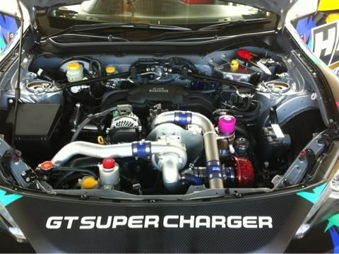

Here is all of the current info on the HKS kit:
1- Compact Size
The GT Supercharger employs the unique Torque Response Traction Drive System to deliver unparalleled efficiency. This system makes the size compact and the supercharger more durable even under high load.

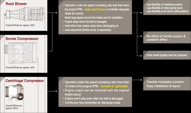

2- High Efficiency
Comparing to the conventional positive-displacement superchargers, the centrifugal supercharger has higher compression efficiency. Also, the Torque Response Traction Drive can improve the transfer efficiency and reduce friction comparing to the conventional centrifugal superchargers
3- Noise
Centrifugal compressor eliminates the pulsation noise of discharging air. ハAlso, the traction drive utilized with the HKS GT Supercharger does not make gear noise. Furthermore, "No Backlash System" in the transmission eliminates noise under the input torque fluctuation.

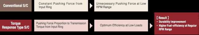

4- Durability and Fuel Economy

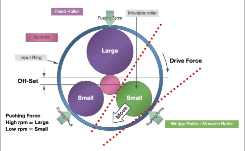

Torque Response System which eliminates unnecessary pushing force and restrain the stress amplitude, appropriate surface process, and material selection can extend its fatigue life. At low load the pushing force is proportionally low, resulting in less fuel burn than that of other traction drive supercharger designs, which improves fuel economy.
When the turning force is increased, the roller moves toward the wedge (narrower) side. The wedge action makes the pushing force corresponding to the turning force deliver the turning force from the input ring to the output axis
Some Images:

In the images shown there is definitely no AC, it has been deleted.
This is a very difficult car to SC as can seen by the need to ditch the AC system

Definitely not an easy SC job, but it appears from the top pic that HKS made it work, and retained the AC. If the engine hadn't been pushed lower and farther to the back. it may not have been possible.
