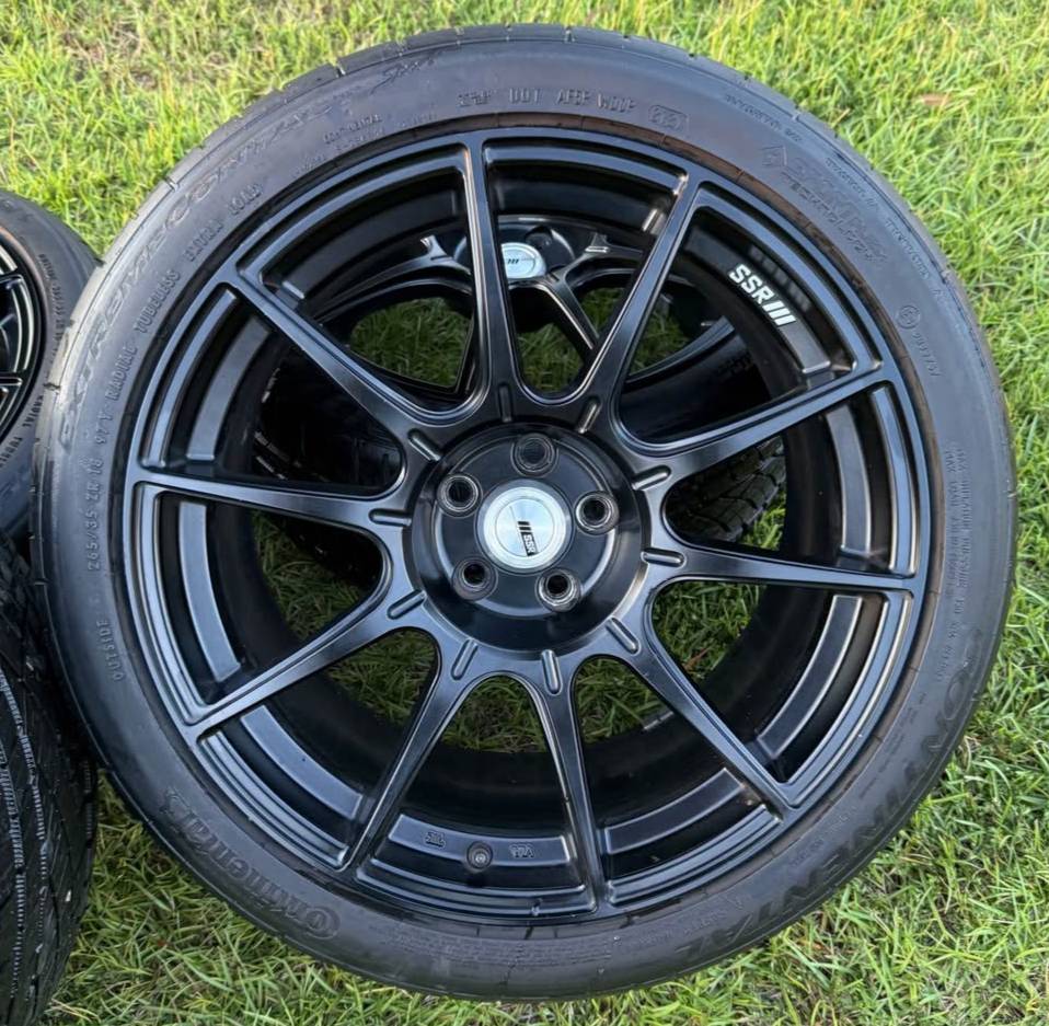

Picked these up for my '19 86 TRD while working out of state. I drove 4 hours (2 & 2) to pick them up. I got a great deal on the wheels and tires.
They are in pretty good shape but I'm still going to get them refinished and change the SSR logo on the wheels to a Cusco blue. I may keep the same black color though. I'll end up replacing the tire brand with something Japanese.
I'll be swapping all the red in the TRD for a cusco / anodized blue color.
Square Setup:
SSR GTX01 5x100 18x9.5 +40
265/35 ContinentalsName:  SSR GTX01 5x100 18x9.5 +40 - 2.jpg
