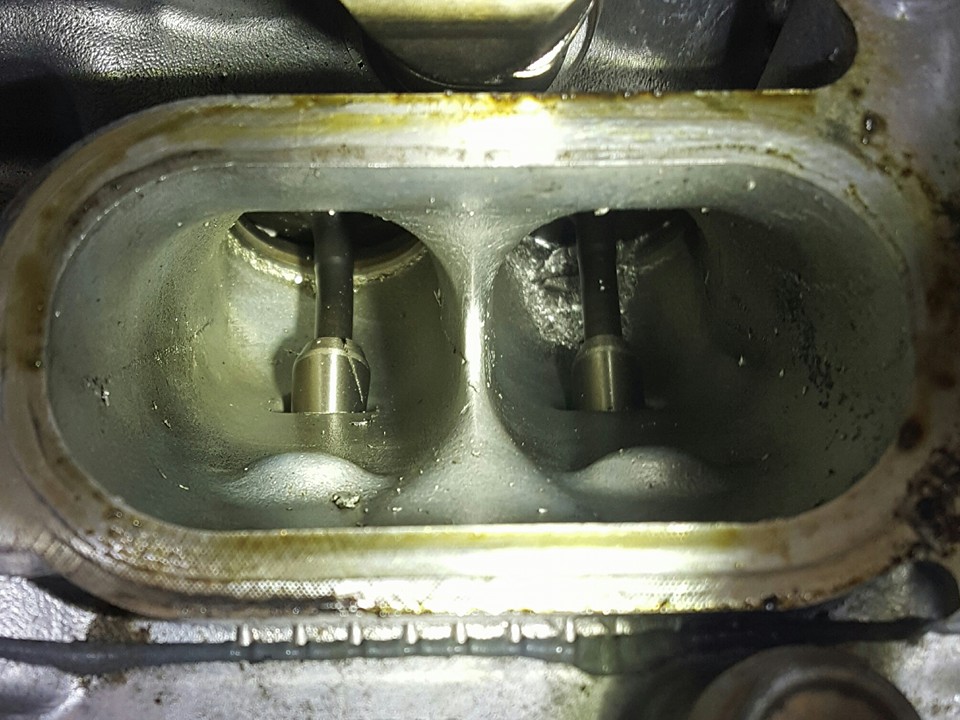

9~10 psi bent rod cylinder #4. I think #3 was slightly bent. #2 looked straight. #1 threw everything through the block. haha I think cause was valve float and/or tossed rocker. You can see in the intake port pic where only one valve was bent/damaged. Exhaust side was fine. Stock 2012 engine. This was awhile back but just now getting to look at the damaged engine out of curiosity. If the valve spring/rocker incident didn't happen, it would have been a matter of time before something else would have.

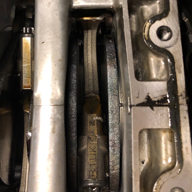

So the symptom of the bent rods is the air/fuel ratio changing. I had some problems with the A/F drifting over a few weeks and the ECU needed to perform a lot of fuel trims to try and compensate. We couldn't figure out why. Faulty MAP sensor or Lamba sensor? Changing the engine efficiency table an it would be sweet, and then drift away again.
Turns out the compression ratio was changing as the rods bent and lowered the CR. All 4 rods were in fact bent - the photo is just the worst two of the four.

Tell me how you'd figure rods are slowly bending? There was no engine noise or knock - until there was...
