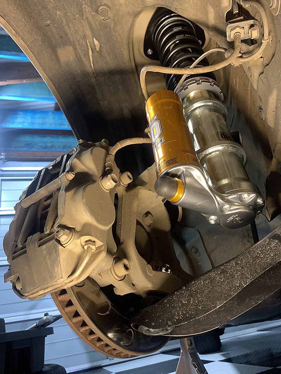

Fronts complete and fitted.

I'm trying very hard not to ask about the specs...
I would see if I can do some kind of clear heat shrink or wrap on the canisters and shock socks, at least for the front strut. Gotta protect that beautiful finish.
