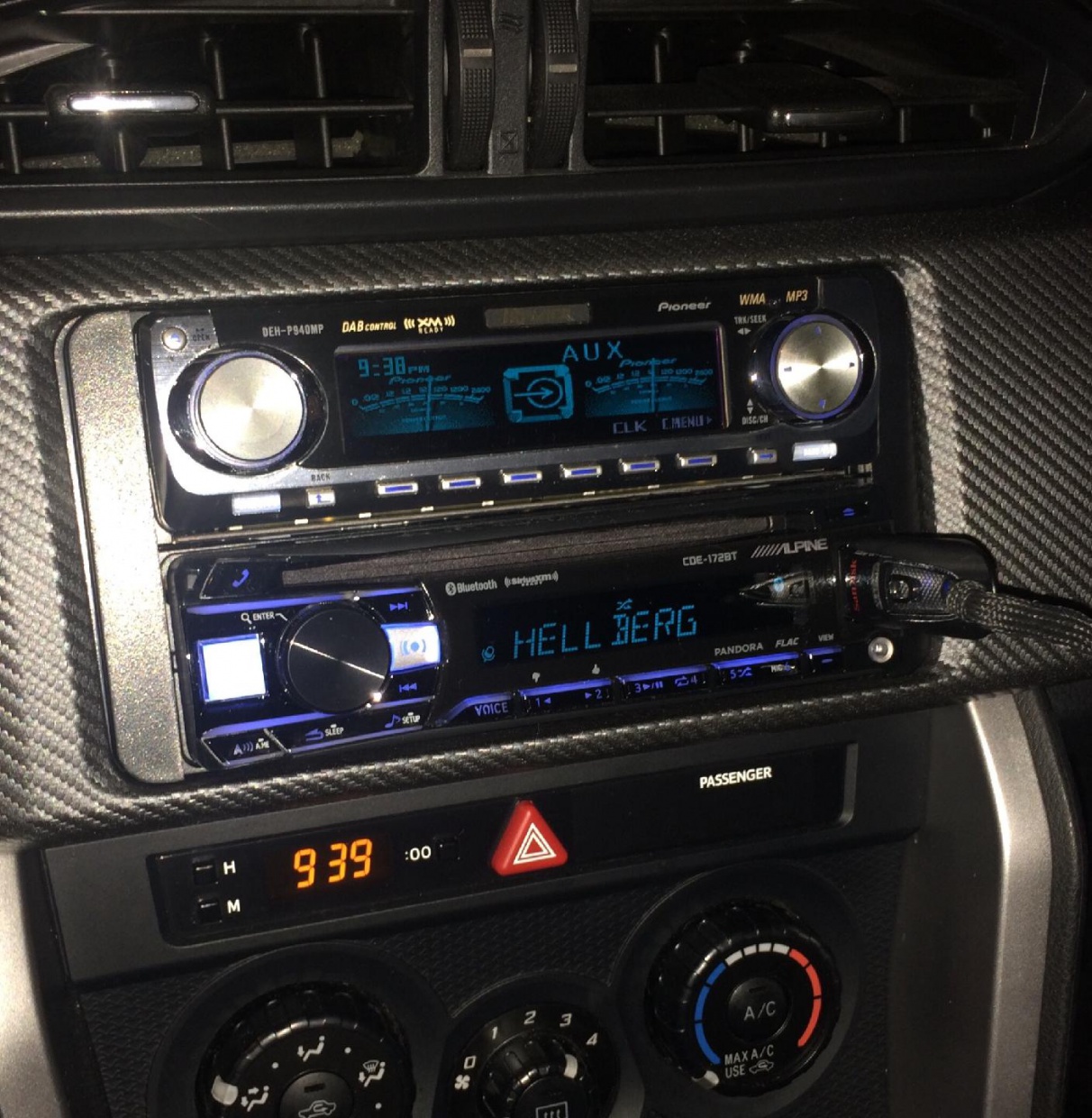

Yes, the deck will come with most of the wiring harnesses to install it into a vehicle, but Sony doesn't know what make or model of vehicle that you will be installing it into so you will need a dash kit, Metra and Scosche both sell one, and a wiring adapter harness to adapt the Sony harness to the Toyota/Subaru harness.
However, Crutchfield is very good at matching their available installation materials, such as harness adapters and dash kits to our vehicles, of which you will need both to fit a single DIN unit into one of the twins. I know, I've got two single DIN units installed into my dash and had to further customize the kit after I got it to make it work.

Based on the above picture, a flip-up is going to block the air vents. Single-DIN kits mount the radio on top and a storage pocket below.
I suppose you could try flipping the kit, but I don't know if that's possible in our cars due to the shape and mounting points of it.

Hm.. Based on the photos of the headunit and the fact that it can articulate up and down, even if we were to use a single DIN adapter such as this Scosche one, I'm thinking we can push the headunit screen down so it doesn't cover the vents. I would have to do measurements to see what precisely it would cover up (air vents, clock, etc.), but just looking at it it seems like it could work...
Attachment 199764
Thanks, that is helpful. I think I will be able to use the Scosche single DIN adapter you mentioned. All I need now is to find the appropriate wiring harness for the Sony to BRZ, I believe.
