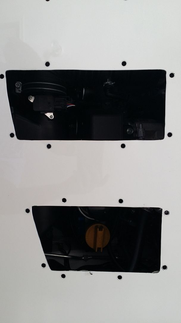

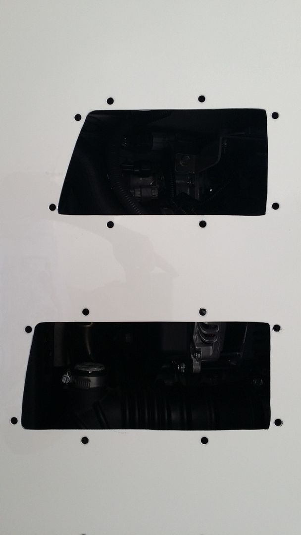

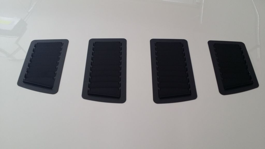

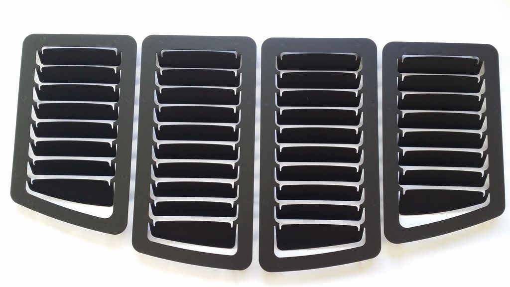

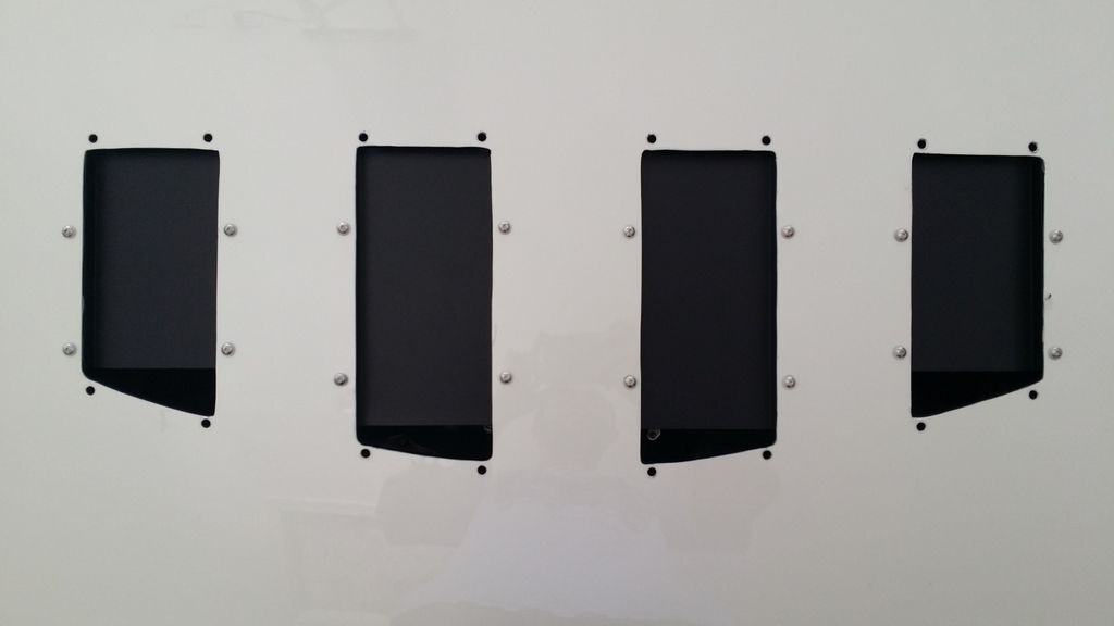

Sorry, photo overload. Doing my best to show exactly what you will get and can expect from the install.
Driver's side louvers not installed, showing what is directly below louvers.
Passenger side louvers not install, showing what is directly below louvers.

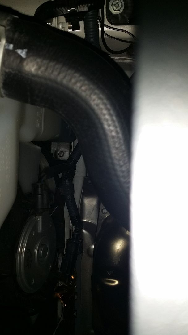

Rain guards installed (without louvers of course). Each one dumps the water on/near the radiator. The fans are 100% waterproof and made to see water, they see water whenever it rains.
Directly below passenger side most rain guard showing run off area.

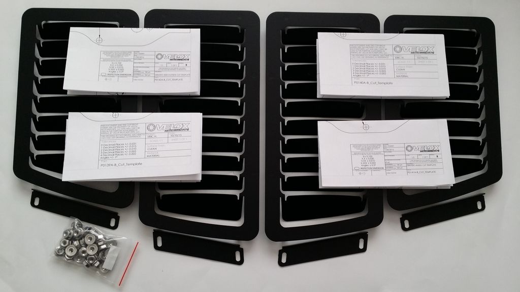

Full kit laid out. Templates included.
Up close of clinch studs off car.
Full kit installed with the powder coated sheet metal wickers.

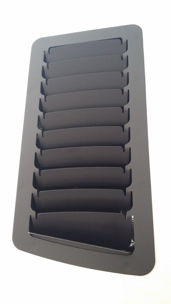

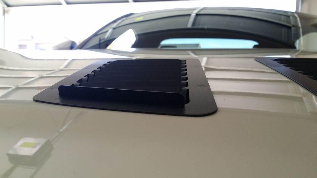

Single unit up close installed pic.

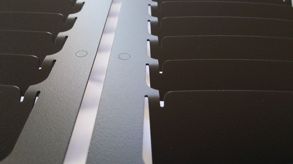

Another close up picture to show you the slight distortion from the stud being tightened by the nuts below.

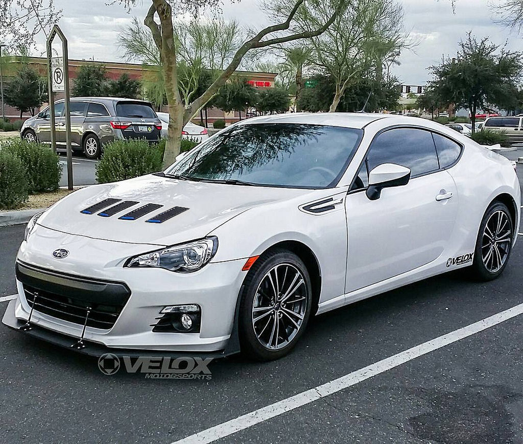

Do you have an under hood shot? Maybe I missed it somewhere... Wondering if the inner two vents can be installed in place of the outer vents?
EDIT: Nvm its on the first page.. doh lol. Looks like it will fit!
Some chops, used the same image as previous... because why not.
Top = 4x Larger inner vents
Bottom = 2x Larger inner vents placed on the outside
