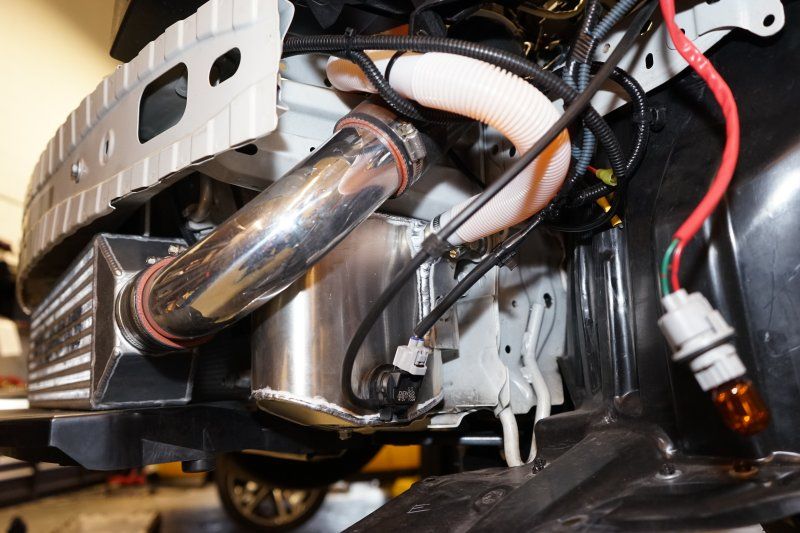

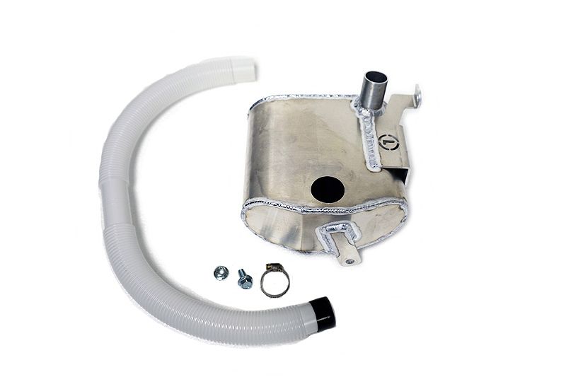

The PTUNING Windshield Washer Reservoir is done and should be ready to ship out beginning of next week.
- The aluminum reservoir holds 3.5 quarts of fluid--definitely plenty for the DC metro winter. Sized to allow for provision of brake cooling ducts.
- Installation takes less than 30min once the front bumper cover is removed.
- No modification of any kind required.
- The reservoir will reuse the factory reservoir's fill neck, mounting clip, pump & grommet. So dig up those parts you removed during the original turbo system installation and have it ready, if you decide to purchase our reservoir.
Contact your PTUNING sales rep for pricing if you're interested--quantity is limited.

Originally Posted by Mrc@ptuning View Post
The PTUNING Windshield Fluid Reservoir is done and should be ready to ship out beginning of next week.
http://i334.photobucket.com/albums/m...psaf69fbe7.jpg
http://i334.photobucket.com/albums/m...ps8704acf2.jpg
Woohoo... almost forgot about this!
