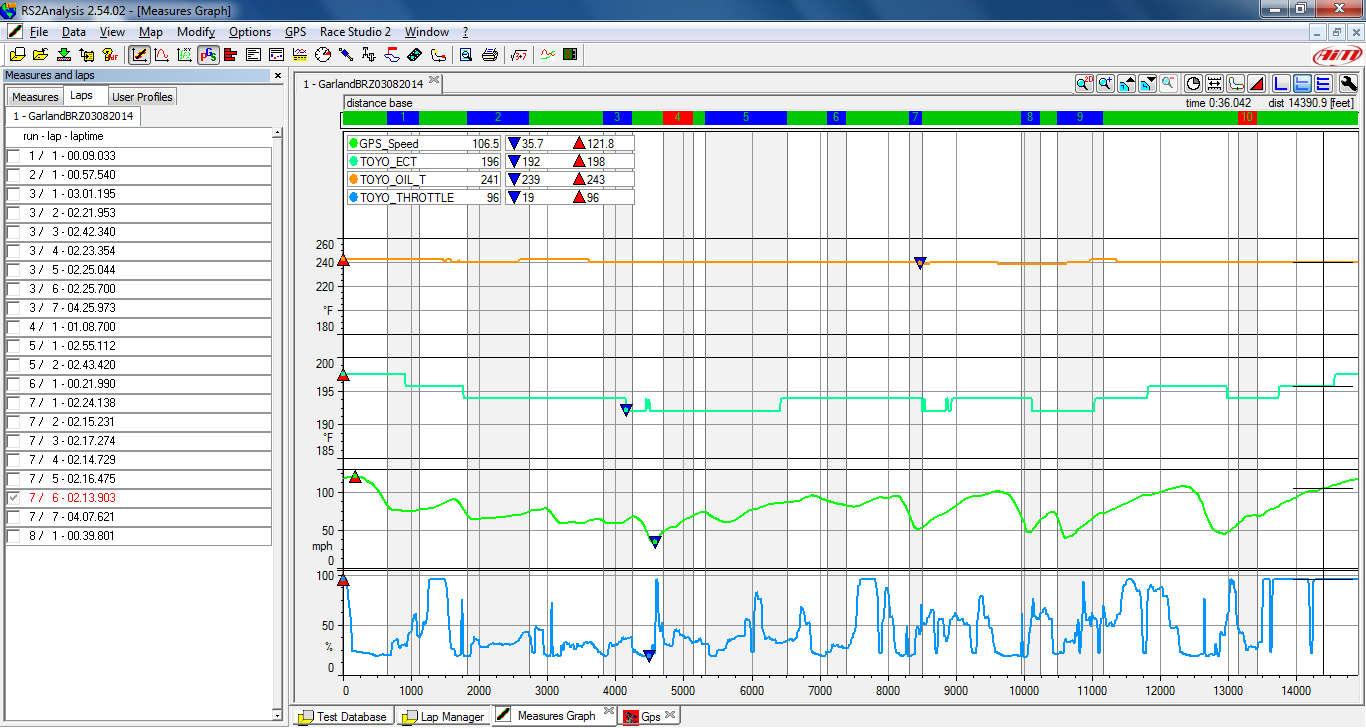

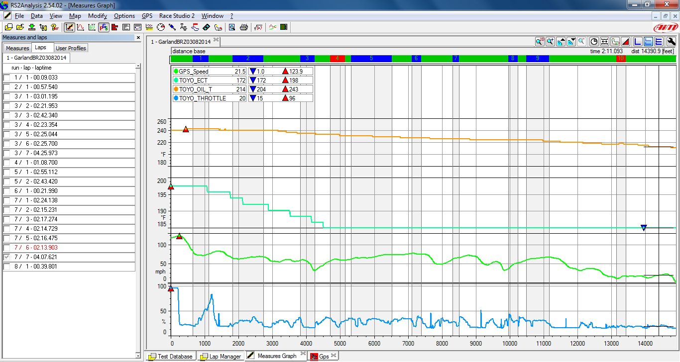

I've put together some graphs to show the rate at which the temperature drops during a cooldown lap. I can put one together to show how it rises, but it just climbs steadily lap after lap. Not sure how to display that in a way that provides value.
This was on the second day of the 2-day event, which was MUCH cooler (~85-90F ambient). The first day (~105 ambient), we saw temperatures more than +15F on top of these numbers.
Orange: oil temp
Cyan: water temp (known AiM Solo bug, reads low, so add +18F to it)
Green: speed mph
Blue: throttle %
X-axis: distance (feet) Left side is the starting line, right side is the end, which loops back to the starting line.
Best lap, going all out (part throttle all out :p)
Oil temps were holding steady at around 240F
Water temps were peaking at 216F on the long WOT front straight
Cooldown end-of-session lap immediately following the previous lap
Oil temps gradually come down
Water temps drop like a rock within the first 4 turns to a very happy 190F

Thanks for the data. I'm sure with some more seat time, you'll be using more and more of your available power going around the track.
The first part of my turbo water line theory will be tested this weekend. Given all the information I have so far though, I'm fairly confident that the water temps for the guys running on track have been in check all along. We'll find out soon enough though.
