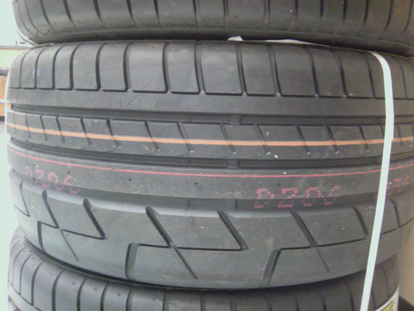

Originally Posted by AZP Installs View Post
On track I am running the following:
OEM setup w/re070 tires
AMB: 75-85 deg
Coolant: 215
Oil:260-275
OEM setup w/re070 tires and koyo rad
Coolant:199-205
Oil:260-275
We are going to try out an OTS oil cooler this coming week and will have some hard numbers after that.
Mike
I love the sidewall and look of those tires...
These are going on shortly...
Best deal for doing TT or HPDE with. Takeoffs from Bimmerworld, DIRT CHEAP.
