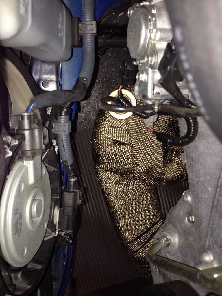

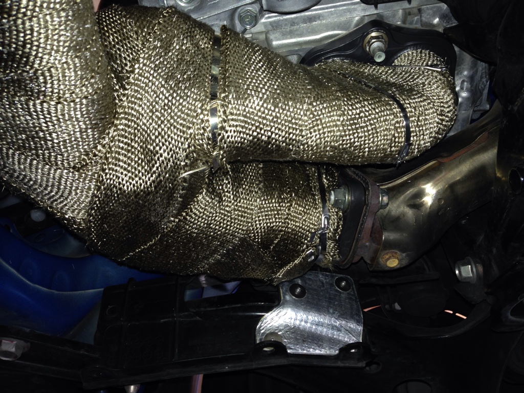

I wrapped my coated Gruppe-S headers with a generic titanium wrap I got on Amazon. I was going to get the DEI one but they don't ship to California. We'll see how it holds up.
Also, I wrapped them while they were on and it was a pain. I would have gotten a better wrap job with the hem off but I didn't want to remove them. Didn't come out that bad though.
Attachment 127900
Attachment 127901
Attachment 127902
That looks like dei. Auto zone has dei
