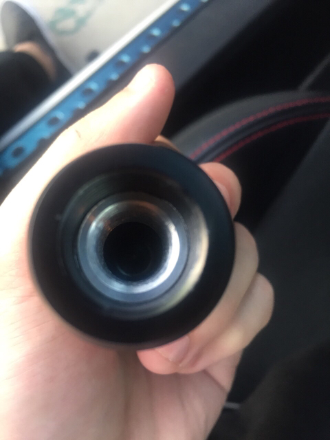

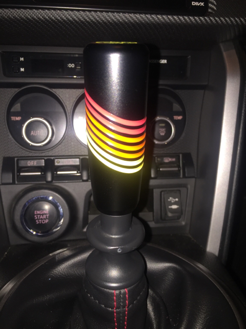

Hey guys, I just got my new shift knob and I install it and tied, than I recognized I can't use my reverse lock, but I can't get my bolt inside, what can I do right now?Name:  ImageUploadedByTapatalk1455251545.693686.jpg

Originally Posted by ZHoward View Post
Hey guys, I just got my new shift knob and I install it and tied, than I recognized I can use my reverse lock, but I can't get my bolt inside, what can I do right now?Attachment 131123Attachment 131124
English?
I don't know what you are trying to say... but you either need a spacer or an extension is my guess.

Sry about bad English.... I can't get things out that I show on picName:  ImageUploadedByTapatalk1455252076.023348.jpg

Red locktite on a bolt, screw it into the fitting, let it dry overnight and screw the bolt out. Torch the loctite afterward to remove the fitting.
Or just get another fitting and leave that one in there.
