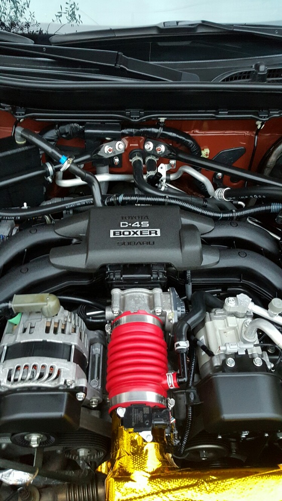

I waited about 5min, then resprayed a few areas. Outcome is below.
Final step:
Re-add the battery if you removed, and make sure no plastic pieces are left on. Wait about 2hrs after GUNK dresser is on to start so that it can set on plastics. I waited overnight with hood open and placed a fan on for 40min blowing into engine bay to aid the drying process.
Note: you can start your engine right after you are done washing, but I prefer to be safe and allow water to evaporate.
Also, using distilled water reduces the likelihood of water spots (white spots) on engine components.
I also took over 3-4hrs to do this whole process so my battery died due to having radio on, doors open and trunk open.
Special thanks to the old geezers of ft86club who are always ready to set dealerships on fire when they don't get things their way. You guys know who you are!
Feel free to share how you clean your engine. This is my first time cleaning the FA20. It was a 4/10 dirty. Remember, proper timely maintenance is the key to a long lasting engine.
