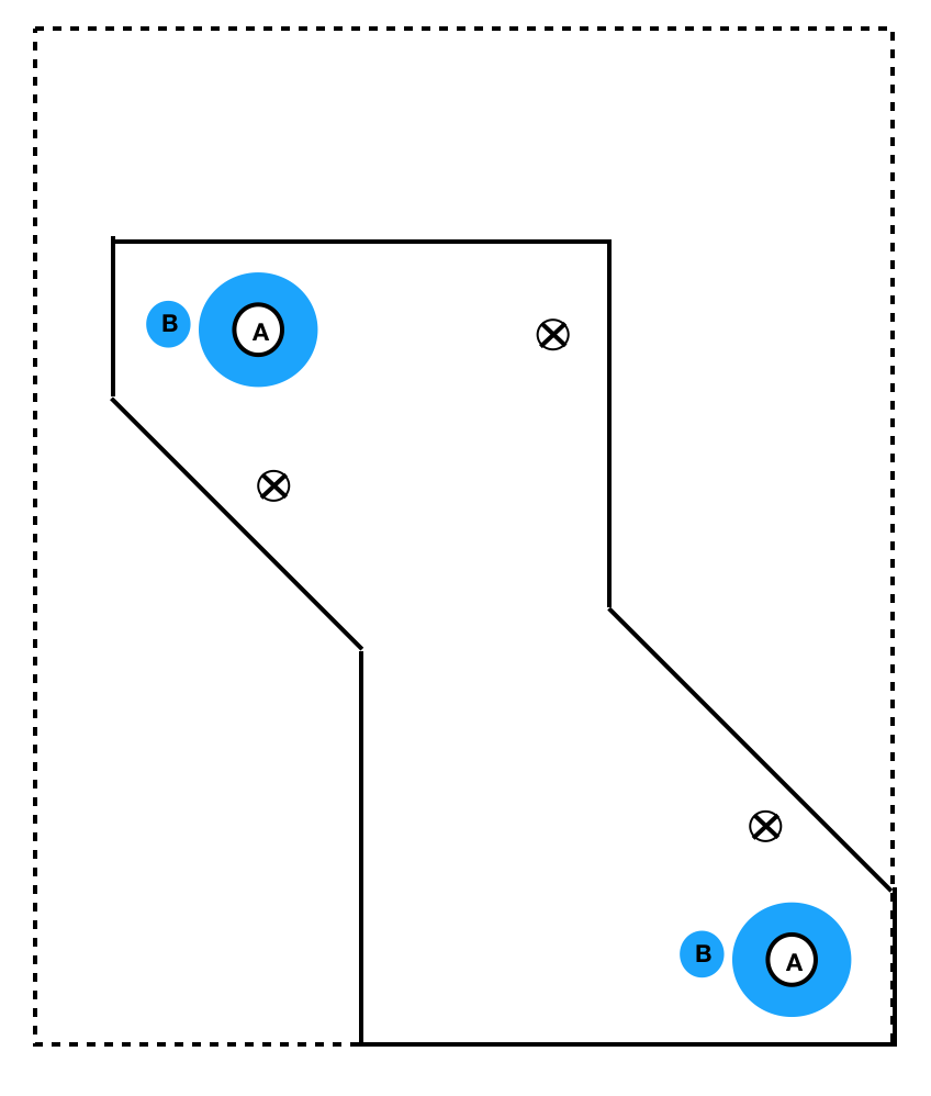

2(picture 1). Place the base of the gas pedal to the bamboo, and outline the shape of the spacer and holes with marker. Here is a rough drawing
- holes labeled A are where the existing mounting bolts will go. These will be used to fix the spacer in place
- holes labeled B are where new mounting bolts will go. These will be used to fix gas pedal to spacer
- holes with x are screw holes for screwing two pieces of bamboo together
- the distance between holes A and B will determine how far left the pedal will be moved. I used 15mm space between the holes.

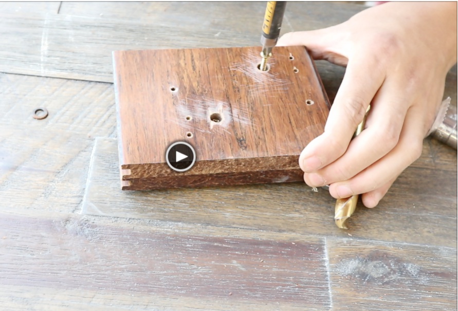

3. drill guide holes for holes A, B and x
4(picture 2). apply wood glue to the back of 1 piece of bamboo board. Slap the 2 pieces together and wipe off excess glue. screw the 2 boards together with holes x. The 2 boards combined will be about 1" thick. same as the Velox spacer. Make sure you drill a wider hole about 1/4" into the wood above each screw hole so the base of the screw will not protrude from the mounting surface

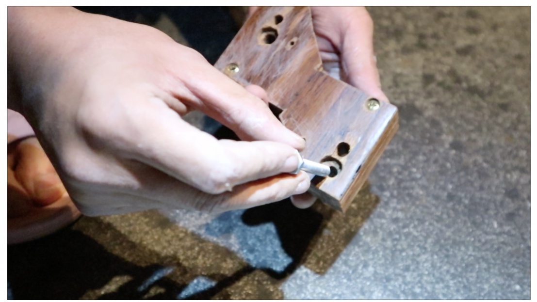

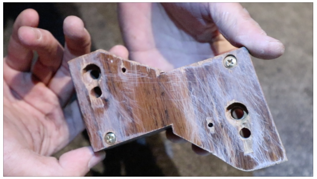

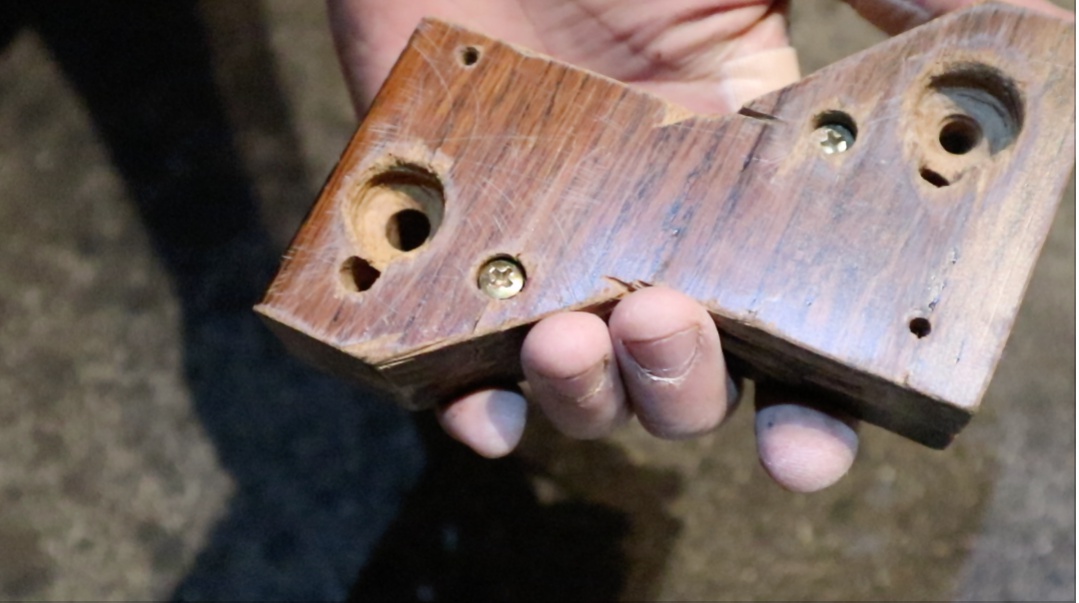

8. Use a band saw to cut out the shape of the spacer. The spacer should now look like picture 3(front). and picture 4(back)
9(picture 5). Test the bolts in the spacer to make sure it fits properly.
10. Use the Belt sander to smooth the cut edges/drilled holes and sand down front/back smooth surfaces to expose the unpainted wood surface and make it pretty. This is also where you can adjust the thickness of the spacer to your liking by sanding more or less of the surfaces. Sorry I forgot to take a picture of the finished spacer after sanding before I installed it.

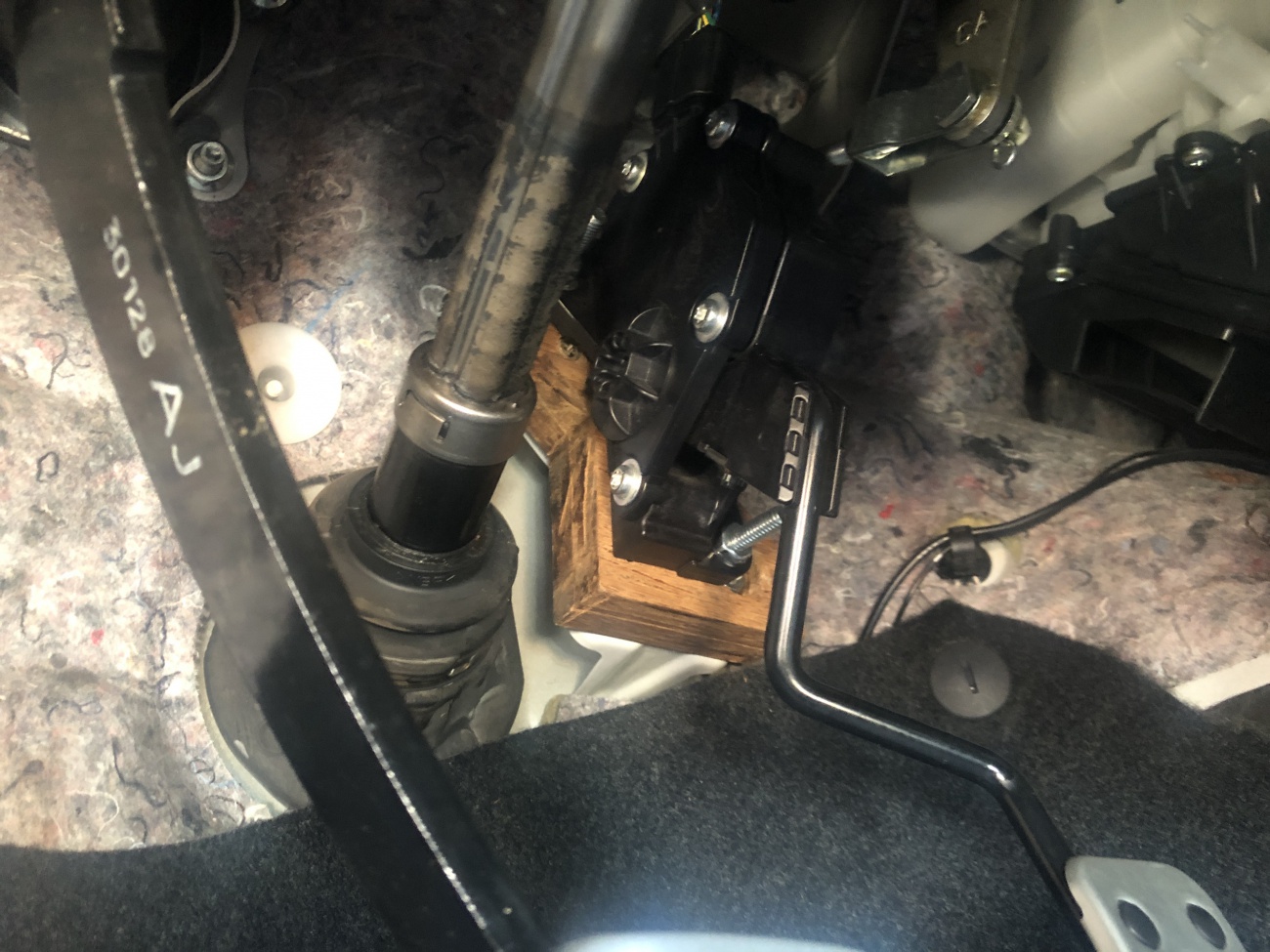

11. insert the new mounting bolts into holes B(this is where you will mount the gas pedal). Feed the spacer through existing bolts on your car through holes A. Use the same nuts that were removed from the gas pedal during uninstall to tighten with the 10mm socket and make sure spacer is secure.
12(picture 6). Insert gas pedal onto the new mounting bolts and tighten with the new nuts and make sure gas pedal is secure. Plug the throttle connector back.
13(picture 7). Final pedal position
