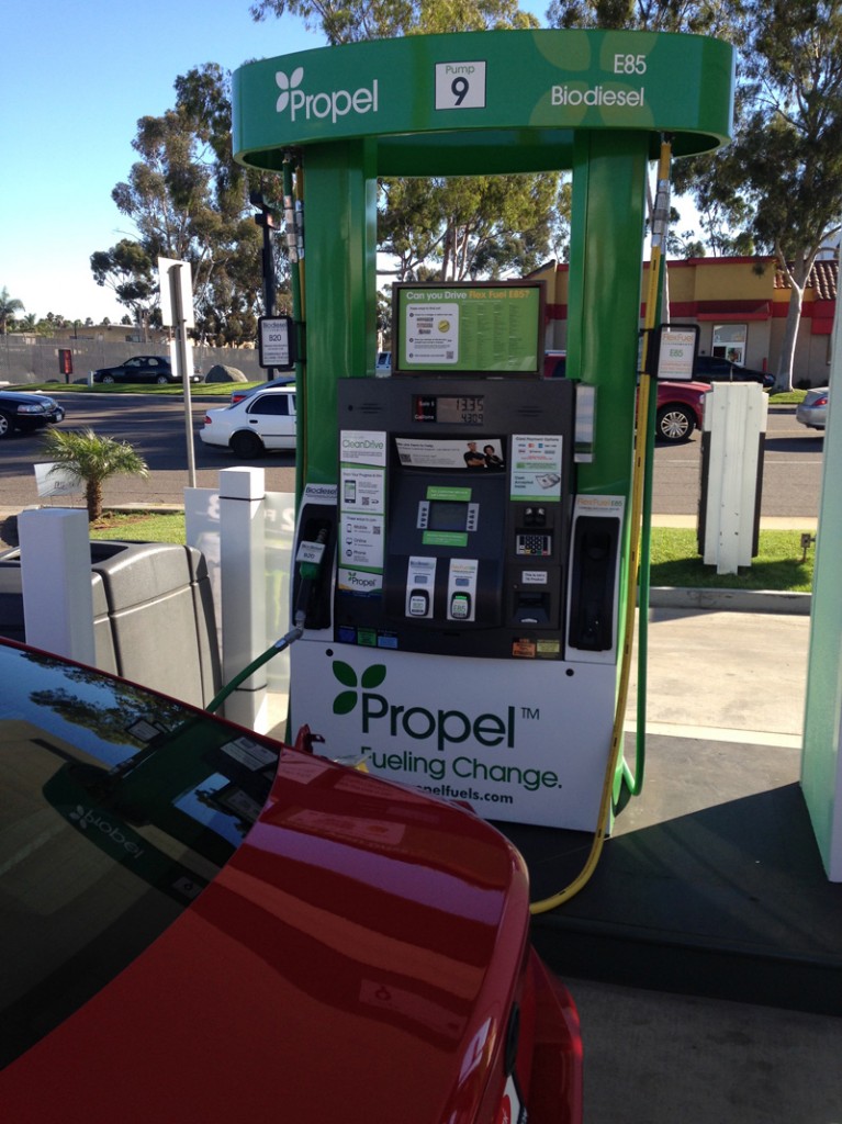

A tune is only half of the puzzle here and the starting point for fixing that damnable torque dip. A Vishnu Performance OpenFlash Tablet is good for up to +20whp right out of the box running regular fuel, but if you switch over to E85 fuel, you can pick up as much as +25whp and +30wtq. A handful of other tuning options are available, but Vishnu and ECUTEK are really the only viable options as of press time.
You can go with either a “Canned” or “Off The Shelf” tune that’s already loaded into the OFT when you get it, or you can see a local reputable tuner and have a map tailored to your car exactly. Even with the same car with the same mods, the output can sometimes vary from car to car, as weird as that sounds, it’s true.
We’ve already discussed how to run E85 in your FR-S or BRZ and covered the Vishnu OpenFlash Tablet in greater detail in that post if you’d like to know more about getting a Vishnu OFT for your Toyobaru.

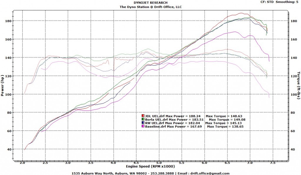

The second part of fixing the torque dip on an FR-S or BRZ is a header.
Peak gains for headers at best, is about +20whp/wtq, but in the critical torque dip, torque increases by about 14wtq on regular pump gas. Borla has two great options available and you’ll see these acronyms a lot – UEL and EL. UEL stands for UNEQUAL length, EL being Equal Length. The main difference between the two is the sound, as performance is about the same. On the upside, whichever header option you go with, you’ll be saving about 10lbs over the stock header.
[ame="http://www.youtube.com/watch?v=S3WrXQrBA44"]Borla R&D: Comparison (17284) UEL V 17285 Header 2013 Scion FR-S/Subaru BRZ - YouTube[/ame]
Borla’s Unequal Length headers are slightly less expensive and this type of header gives you that signature “boxer rumble” you know and love from modded WRX’s & STi’s.
Borla’s Equal Length headers offer a normal exhaust sound and more balanced feel, but both headers will offer very similar gains in HP and torque. As there’s more piping than the UEL header, the Equal Length header costs a little bit more than the UEL, but offers a nice smooth exhaust note without the rumble characteristic of a Boxer engine.
Fitting a header, IN CONJUNCTION WITH A TUNE, will make a big difference in eliminating that torque dip and give your Scion FR-S/Subaru BRZ the power and torque it should have come with from the factory.
So in conclusion, to fix the FR-S Torque Dip, a Tune and Header is a fantastic way to give the car a serious boost in HP, much more than you’d get with many other upgrades. Complementing those mods by running E85 (if it’s available in your area – E85 is readily available in most of SoCal and much of the Midwest) – and the power gains from just the tune and E85 fuel alone are fantastic improvements to help you get more power from your FA20. The right combination of parts can make all the difference, so be sure to talk to the Mod Experts at ModBargains about your build and what your goals for the car are before you drop a stack of cash on your next set of Mods to be sure you’re getting the most power for your modding dollar.
