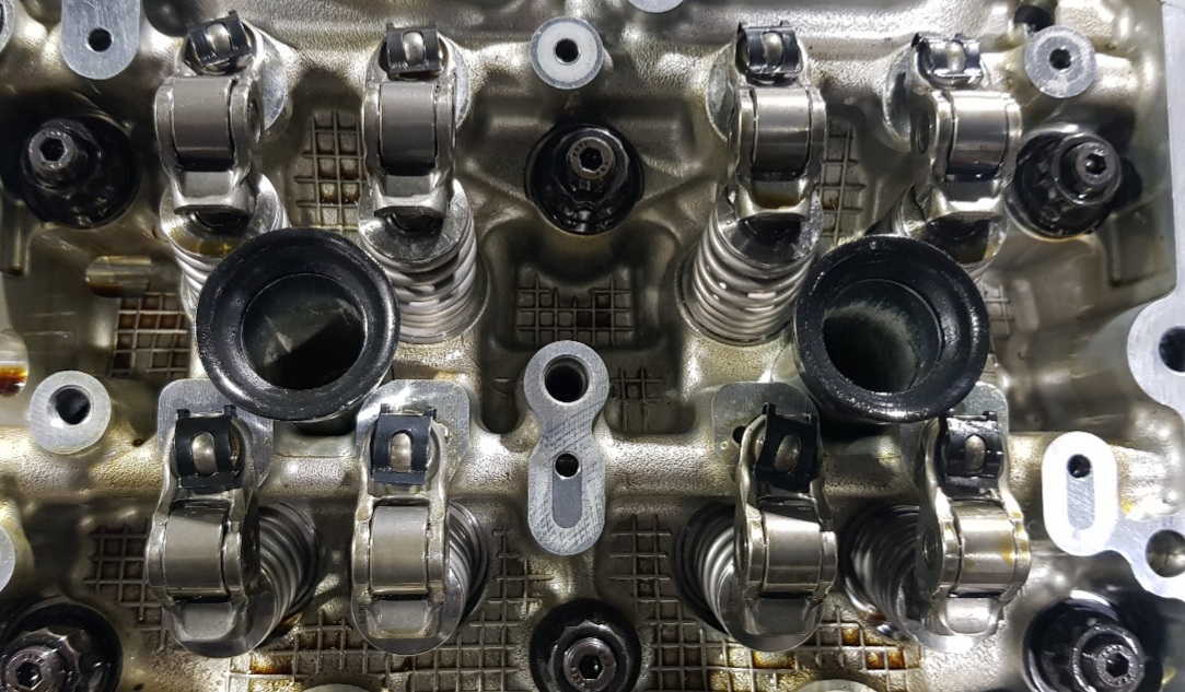

Originally Posted by ML View Post
Also after looking at the retainer kit, I'm convinced that some work on the lathe and right retainer clip you could make your own for pretty cheap.
Yes, it is feasible to make your own like me.
Attachment 197717
awesome! Can you share how you made the clips? I've since decided to just do the k-swap but this could be a great resource for the community.
