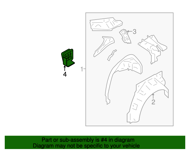

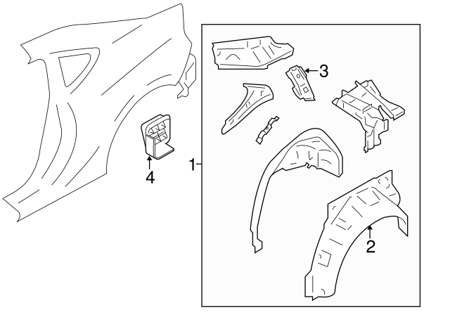

There are (2) ventilation doors that allow air to escape the cabin when the trunk or doors are closed or when the fan, heater or AC are on.
These vent doors are located underneath both sides of the rear bumper behind the rear wheel wells.
Even with the fan off, if fresh air is entering the cabin through the ventilation system or windows... these vent doors are doing their thing.
While driving you may hear them gently open and close... that's what they are designed to do.
It does allow some outside road noise to enter the cabin, especially with an aftermarket exhaust.
They are accessible from inside the trunk or when the rear bumper is removed.
Most cars have them. Video clip a few posts down...

Although the principal is the same the actual parts on the Twins are very different from the picture shown. For one it is on the other side of the car and it is much much smaller. The flaps are just a small piece of rubber not a rigid slat that would bounce and rattle. If you are getting a rattle it isn't the vent.
https://www.google.ca/search?q=su003...AHTcG4EtYmg-KM

https://static.nhtsa.gov/odi/tsbs/20...40470-9999.pdf
Here is a TSB with the revised part numbers for these. 72651CA001 for the BRZ
They can get stuck open in some cases.
tehShirt is offline   Reply With Quote
