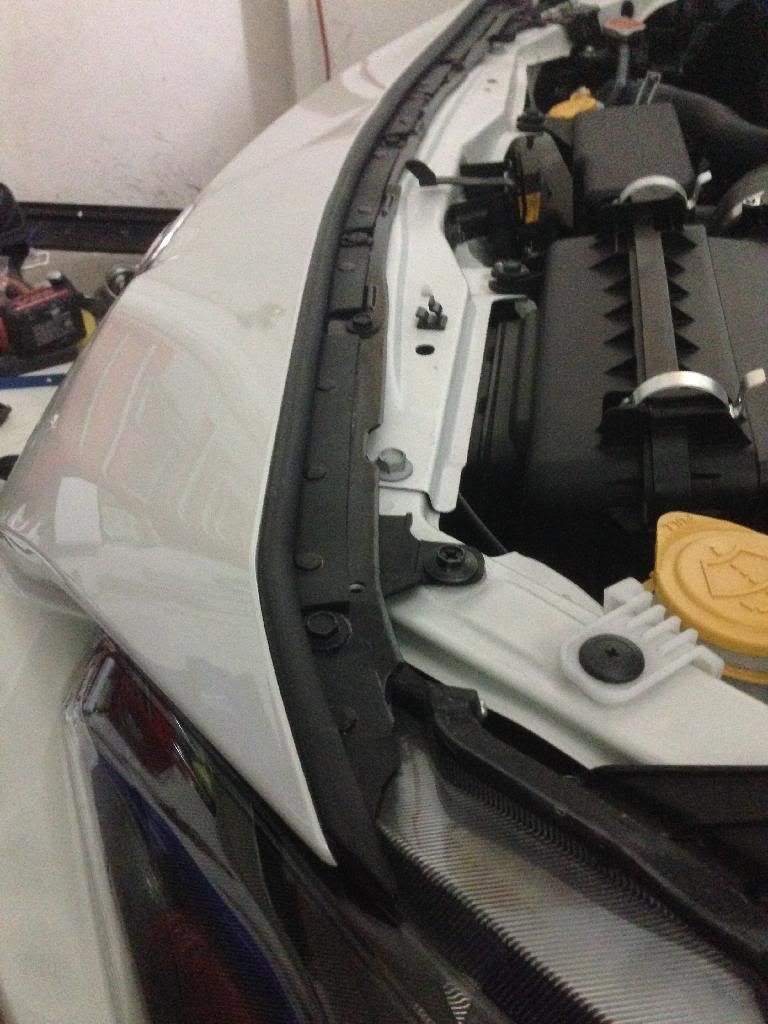

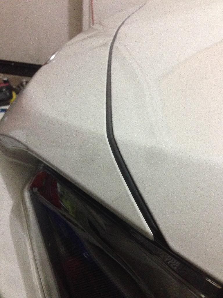

hey guys for some reason when i put my bumper on i have a gap between the hood and the bumper im not sure whats causing the problem because the bumper is fully on and all bolted up does anyone know what it could be

you are missing the metal piece with the rubber seal. Hold on a second, I'll go take a pic

Looks like the rubber black seal strip is missing

Here you go….hopefully it's clear in the pic for you

Looks normal to me, you're just missing the rubber seal that's all.

Alright guys thanks! for your help i put the rubberseal on i forgot that it suppose to go there!
