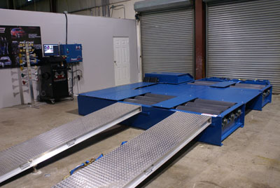

2. Mustang Dyno's - not as nearly as popular as the Dynojet's, but all performance shops that have Mustang dyno's DO have the capability to simulate load on the car to map ECU's. These are also great dyno's, are very accurate, simulate load very well, and are repeatable every time. They are also inertia based dyno's where you'll drive the car up on the rollers (two rollers per wheel and it sits in between both rollers), strap the car down, and make a 3rd or 4th gear pass.
The Mustang Dynamometer is capable of accurately loading 2WD or 4WD/AWD vehicles for the highest level of repeatability in the industry. We utilize a load-bearing dyno that uses an eddy-current load absorption unit with low inertia rollers for precise and instant torque measurement and power production feedback while the vehicle is running.
These dyno's will always read ~12% LOWER than a Dynojet, which is our standard here in the states (unless the shop has messed with the gearing settings in the computer). Because of this, lots of the internet folk don't like to use them. They come on the internet, share their results and everyone says "why didn't you make more power with mod XX". So our theoretical car will show 88rwhp on the Mustang dyno.
These dyno's will always be blue.
