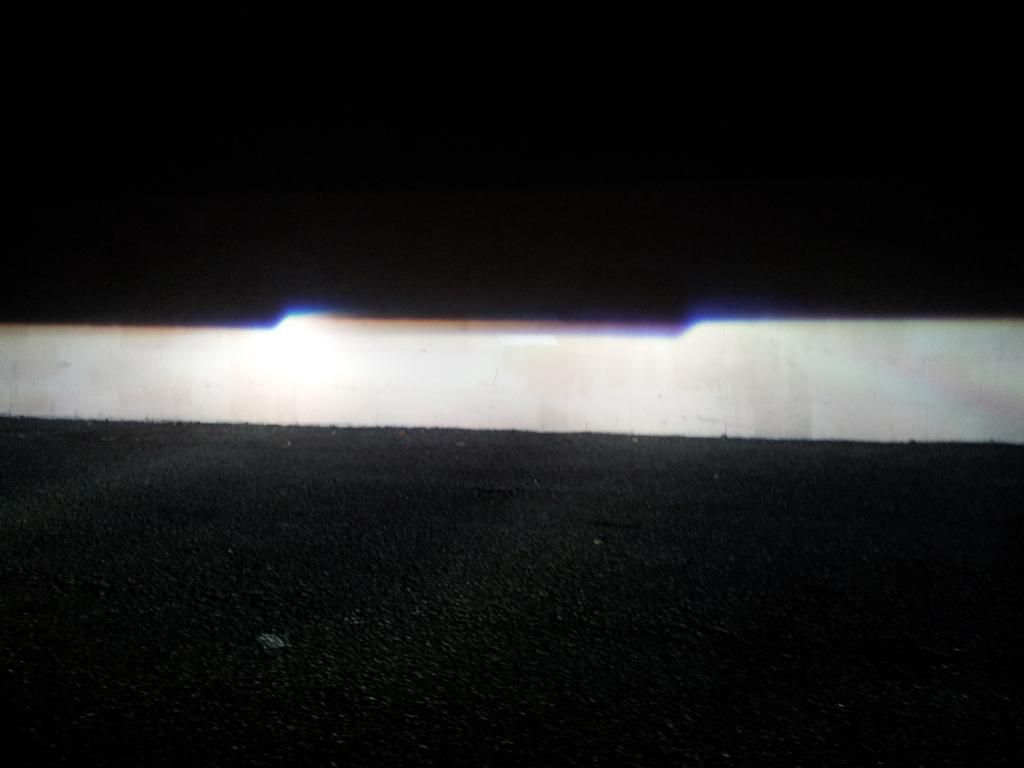

Oh wow, how's the fitment of the S2K?
I currently have the retroquick option with G37 shrouds, but I'm looking to upgrade to better projectors once I sell my demon eyes pair.
The stock projectors actually works quite well with HID bulbs, I tested it but I plugged the squirrel finders. Here's a sample shot with Black Series lens and XB35 bulbs.
I just need to retrofit it with custom shields to make the cutoff sharper and straighter, but light distribution, width and throw are already good.
