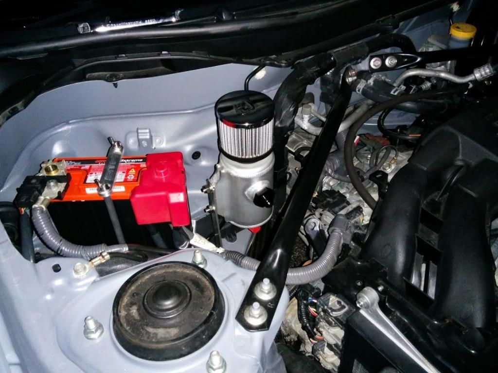

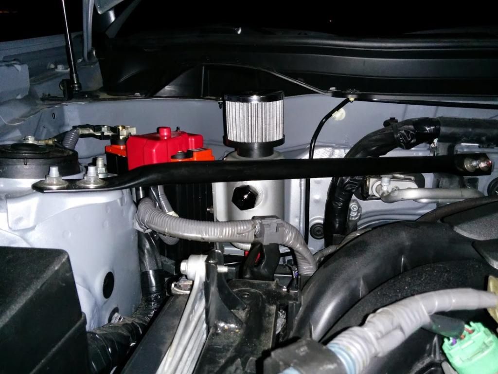

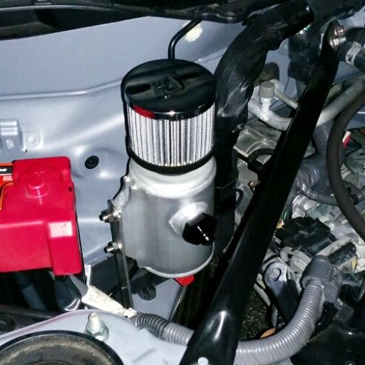

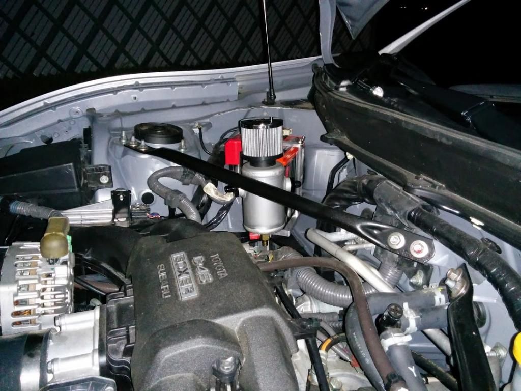

Finally got around to doing a mock up of how I want it. I bought an aluminum bar from home depot. Decided I was going to use the battery tray bolt to mount it. Lifts the battery slightly, but not noticeable in my opinion. It is wobbly, but once the lines are connected and I zip tie them to something or themselves I feel it should be pretty stable. I want to eliminate the PCV valve and run direct to the catch can. Once I find out the the thread size on the block I can then order the appropriate -an fitting. I will be using -6 lines from the PCV block opening and the front vent under the ac comp.
Final install I will also use DEI black wrinkle paint on the bracket and catch can. I will eventually change out the filter to a K&N also.
Let me know what you think.
