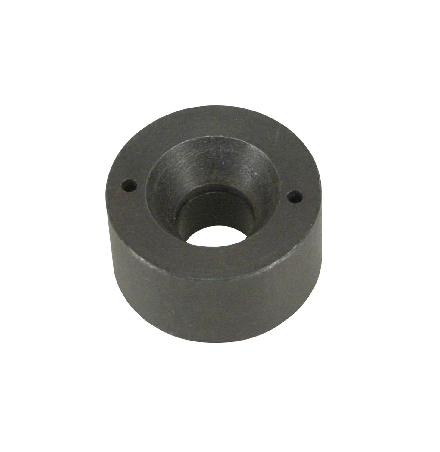

How hard is the install? The hubs are fairly easy to remove as I just did it this weekend. I don't think the front hubs need to come off, but the rears do. Alternatively I've read that non-extended studs don't require hub removal so I may have them machined down.
I have a 1-Ton press at work I can use. I also have this stud installation tool below. Do you think this is enough to get the job done? I can't see pressing the studs in straight but I do think it will be OK with this "puller" tool.
[ame="http://www.amazon.com/Lisle-22800-Wheel-Stud-Installer/dp/B000ETUD22"]Amazon.com: Lisle 22800 Wheel Stud Installer: Automotive[/ame]

I can confirm that fronts can be done with the hubs in the car (remove the rotors though), and rears can definitely not. Stock studs can probably be done in the rear, but the ARP are WAY too long to have a chance of getting in.

Doing the rear on a Saturday wouldn't be too difficult. I used a brass hammer against the stock stud, and had someone else smack the brass hammer with a sledge. (Not hard, just enough to knock them out). Took maybe 5 minutes, then took the hub apart. Used a spacer I had to help install the ARPs. Just lubed up the spacer and lug then tightened it down. Worked great and went quick.

It took me 2 hours to do the whole car (and I did a suspension swap at the same time). I used washers and an old lugnut method to put new ones in. You can lightly tap the oldones out with a hammer. (keep wheel bearings in mind and take your time instead of smashing them out)
