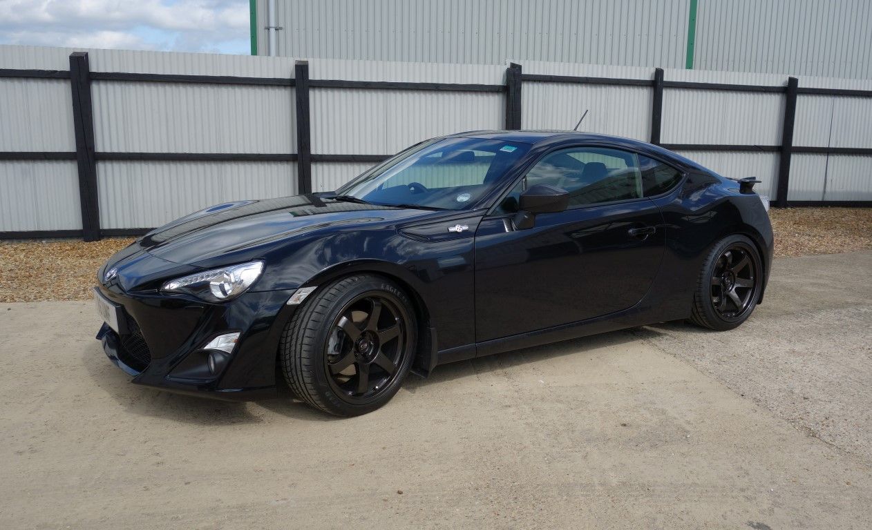

Im planning to buy wheels and tires specs are 18x9.5 +38offset with 255/35/18 tires. what lowering springs(brand and model) would be safe for me to run on without having to roll fenders and zero rubbing issues? thanks

I have Rota Grid 18 X 8.5 ET44 Fronts & Roto Grid 18 X 9.5 ET38 Rears with Goodyear F1 Asym. 2 225/40 front, 245/35 rear. With Eibach Sportline lowered spring kit fitted, there is no rubbing problem at all
