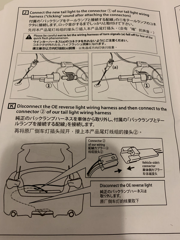

I am hoping someone with Intecs can help me. I just recently purchased a set of Intec tail lights and they ended up not coming with the wiring harness from the back of the lights. I was wonding if someone could take some pictures or if they have a diagram showing how to wire the light into the car?

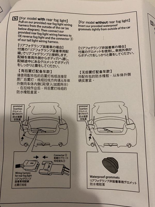

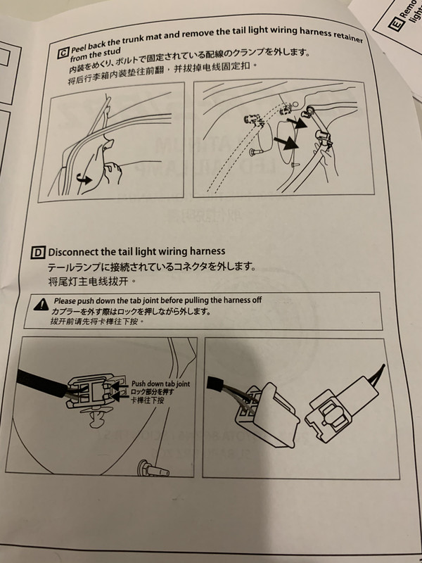

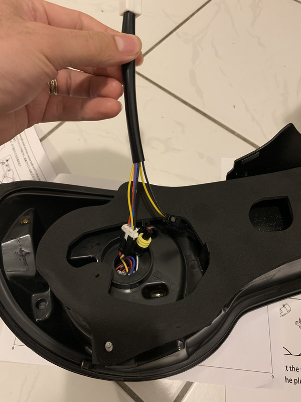

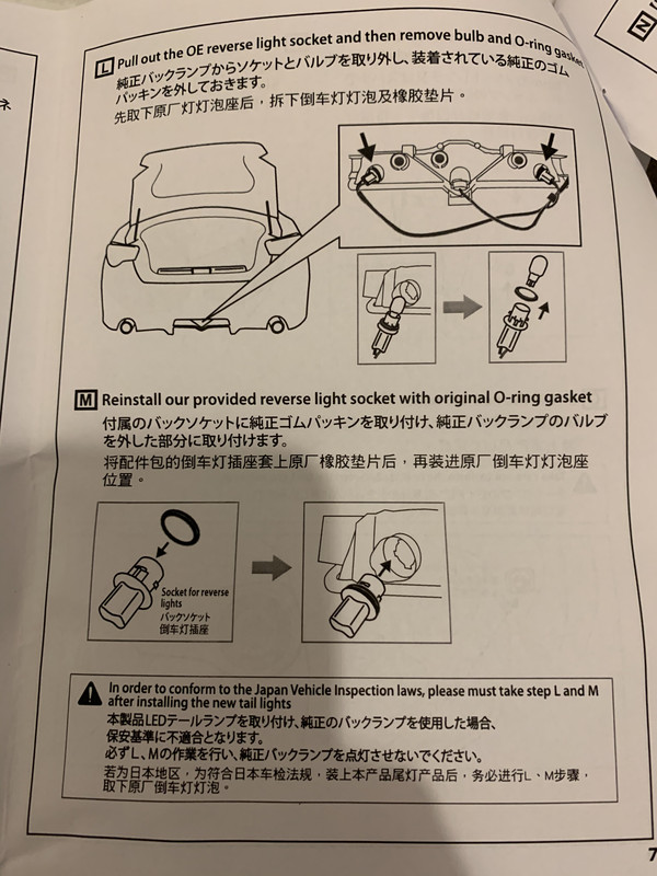

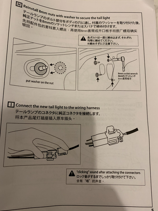

Took some pics of the instructions. Hope this helps.
Let me know if you need any more pics of anything? I haven't installed mine yet

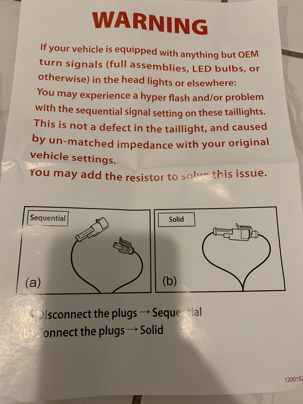

of note, this vehicles turn signal relay is a separate module. the information they give here is for cars where the turn signal relay is integral to other modules, and non-replaceable.
as such, resistors are just a good way to tempt murphies law to burn your car down.
if you experience hyperflash, change the relay with an 'led compatible' version. DO NOT install load resistors.

this is so weird to me, why does is say "for sequential function"?how are the intecs sequential??
im thinking this must be a translation error because as far as i know the intecs are 100% non sequential in terms of a turn signal that goes from left to right/vice versa, like you would see on spyder v1 tails

They probably include this exact manual with other sets of lights, some of which may be sequential. It's a common practice to make one document that covers multiple models.
