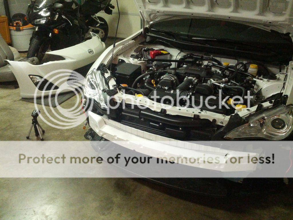

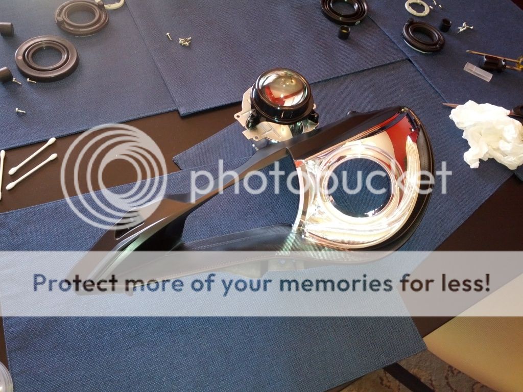

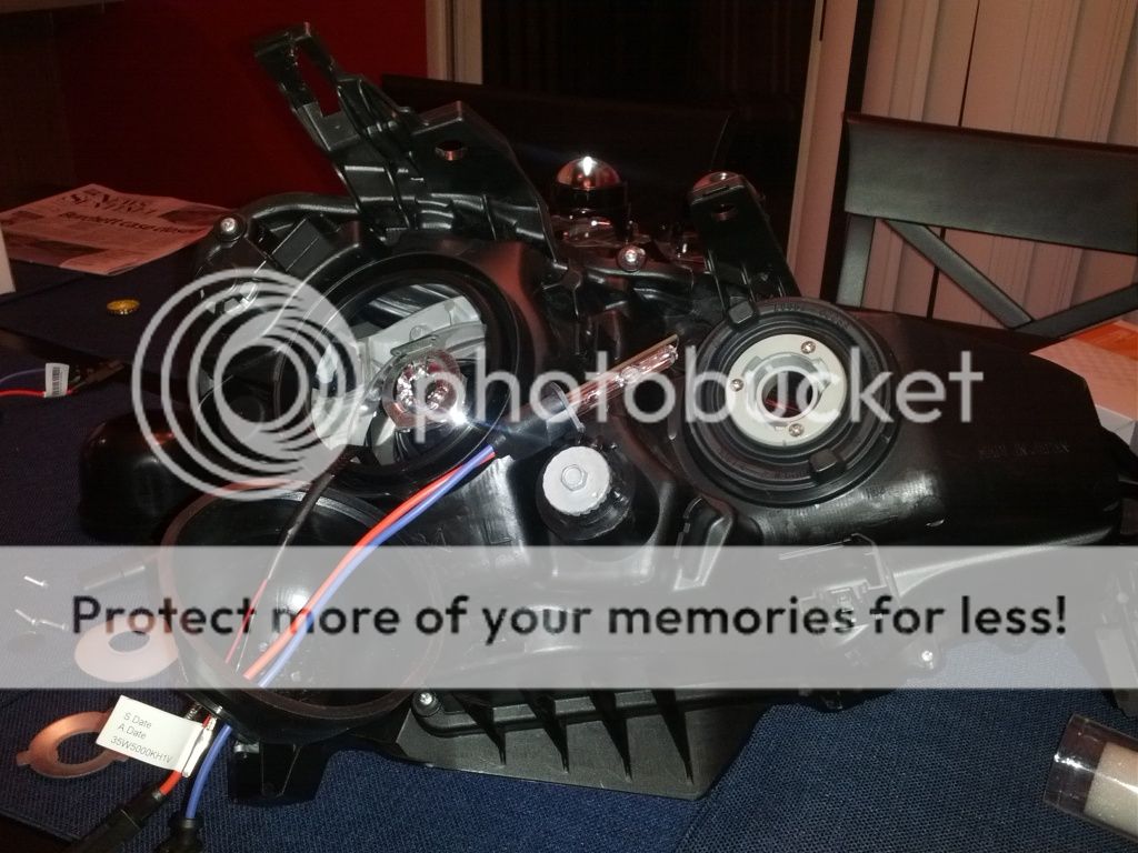

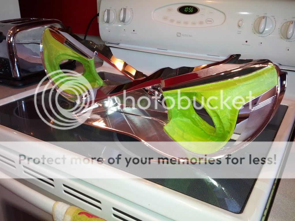

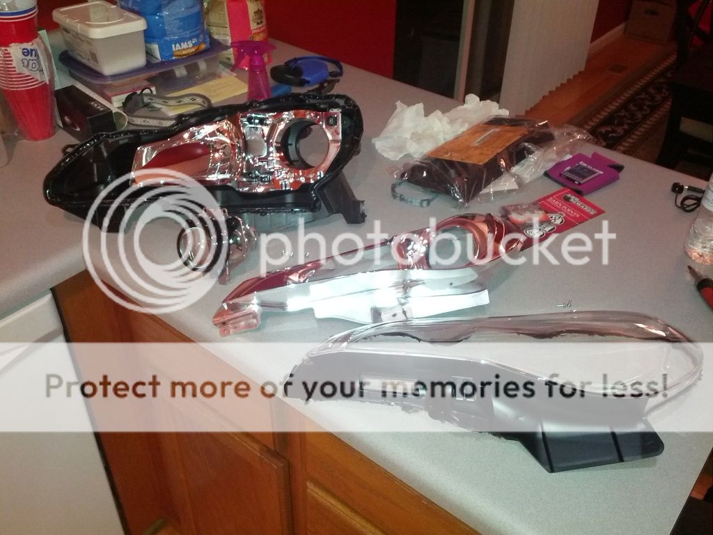

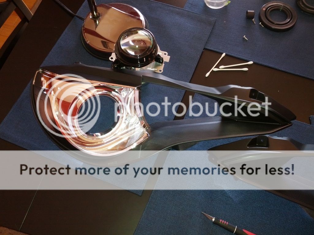

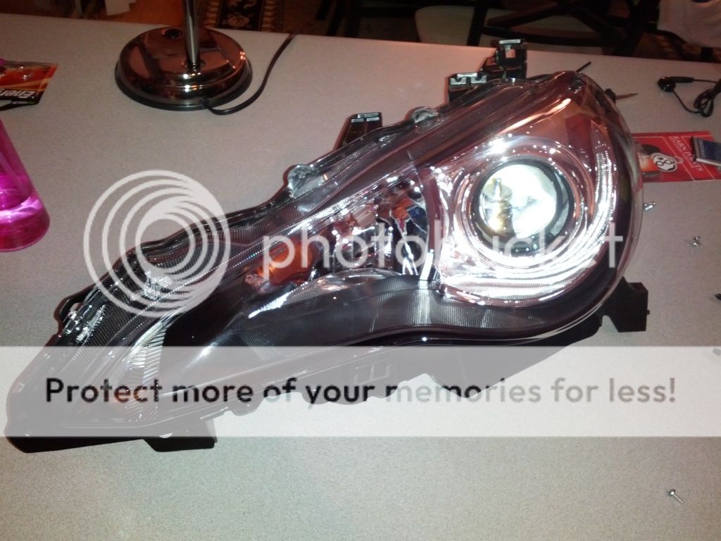

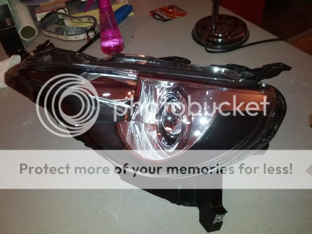

I really appreciate the detailed threads I used for removing the front bumper and opening the headlights. I also was impressed with Andrew at TRS for answering my questions and providing a quality and complete HID kit at a great value. Here's my progress so far...
I did easily remove the corner lights without hurting the mounting tabs. I did this by pushing up on the metal clip to release the bottom of the light. then put a flat tip screw driver in behind the light and pushed out.
http://i584.photobucket.com/albums/s...024_105805.jpg

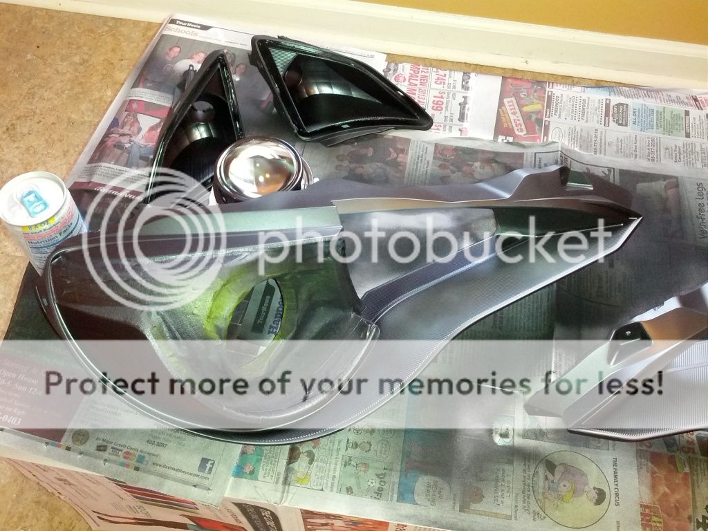

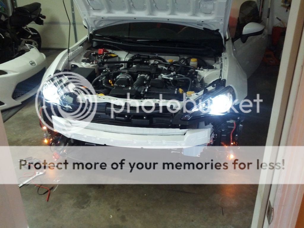

After removing the tape (green Scotch automotive tape) I did have some slight bleed in my paint line. I touched this up little by little with more tape and a very fine brush. I also used a Qtip in mineral spirits to make my lines nice. I have my wiring laid for the HIDs and hope to have finished pics tomorrow.

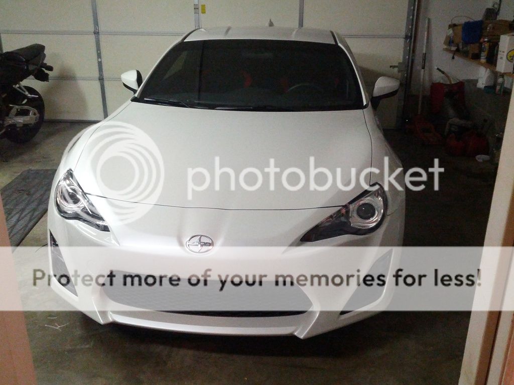

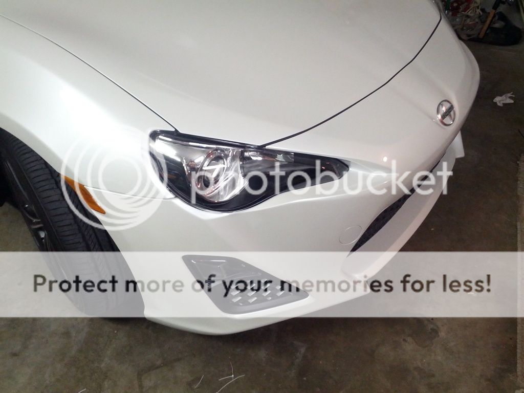

installed pics please! i haven't seen anybody paint only the circle around the projector yet..such as black housing, red circle? demon eye. i saw the other guy did the entire part red.

Thanks guys! I took my time yesterday and had distractiongs and didn't get the car back together like I wanted. Hopefully tonight!

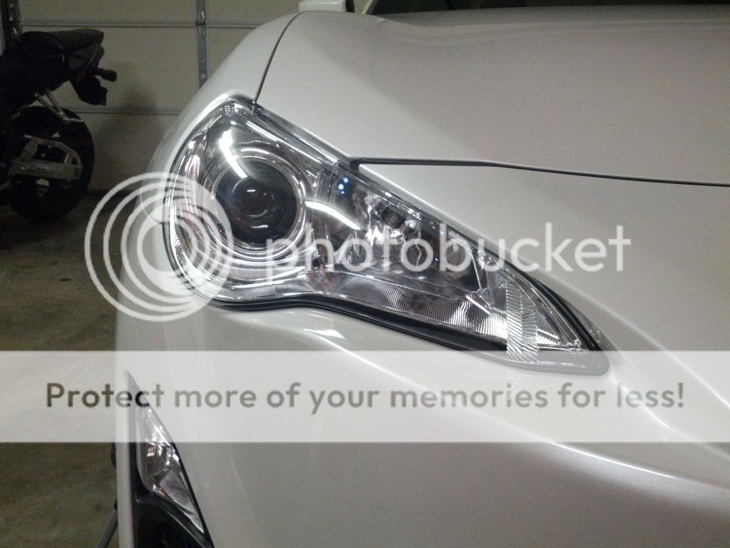

pics added
