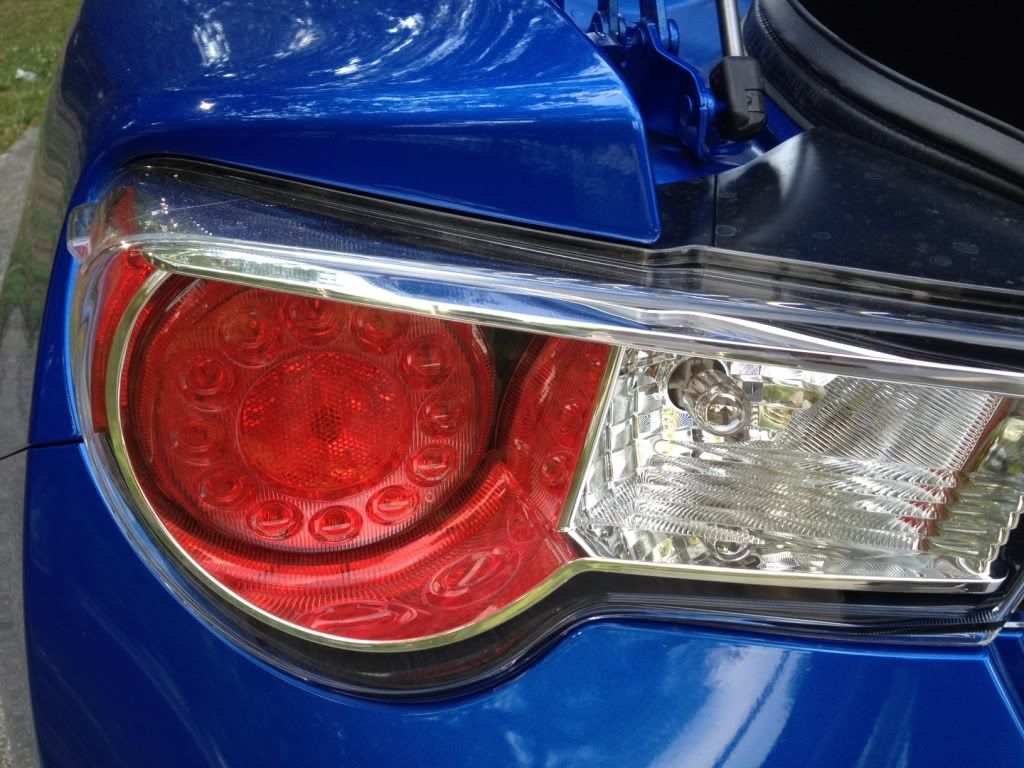

Now, I will start with the trunk. There is just one pop out plug on each side of the trunk, you can stick a flathead screwdrive under it and pop it out easily. Refer to this picture for the location, it's the same on both sides.
Once you get the plug out, gently pull the cover back and you should see the socket for the bulb. Twist it and you will be able to pull it out. You can see it under the white wireloom, closest to the trunk opening, it's the gray housing.
The bulbs simply pull out of the socket and then just push the new chrome bulbs in.

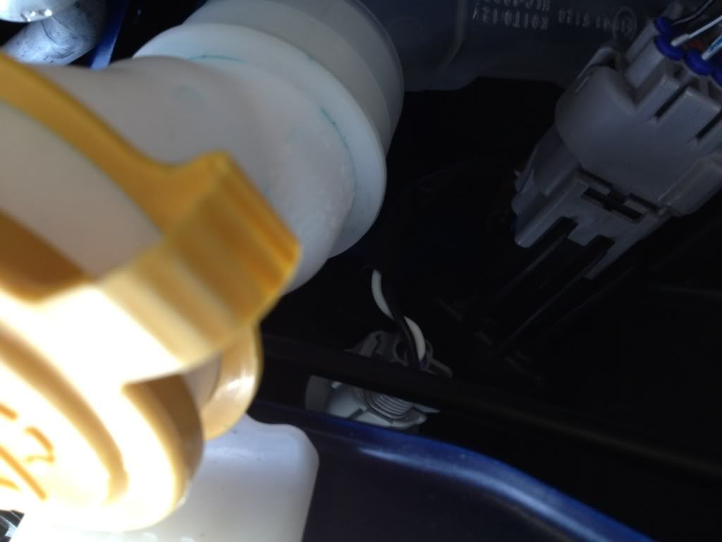

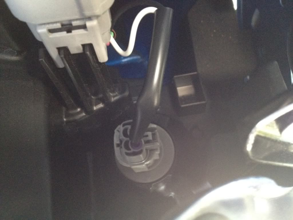

We'll start with the drivers side. These are a little more difficult to spot since you can really see them. If you lean forward and look down, you should be able to spot it. Removal is the same as the rears, just twist and pull out. Here is a picture for reference, it's the gray one. Picture is upside down.
Now over to the passenger side, same as the driver's side.

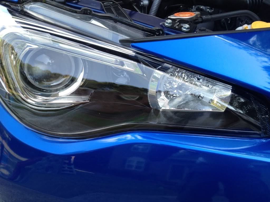

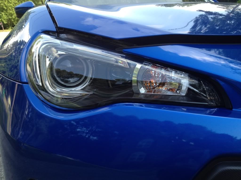

Headlight Before:
Headlight After:

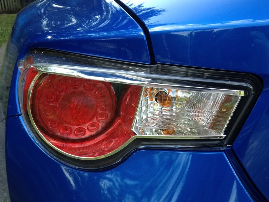

Tail light Before:
Tail light After:
