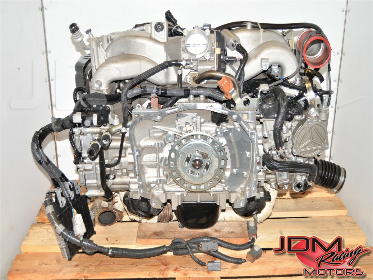

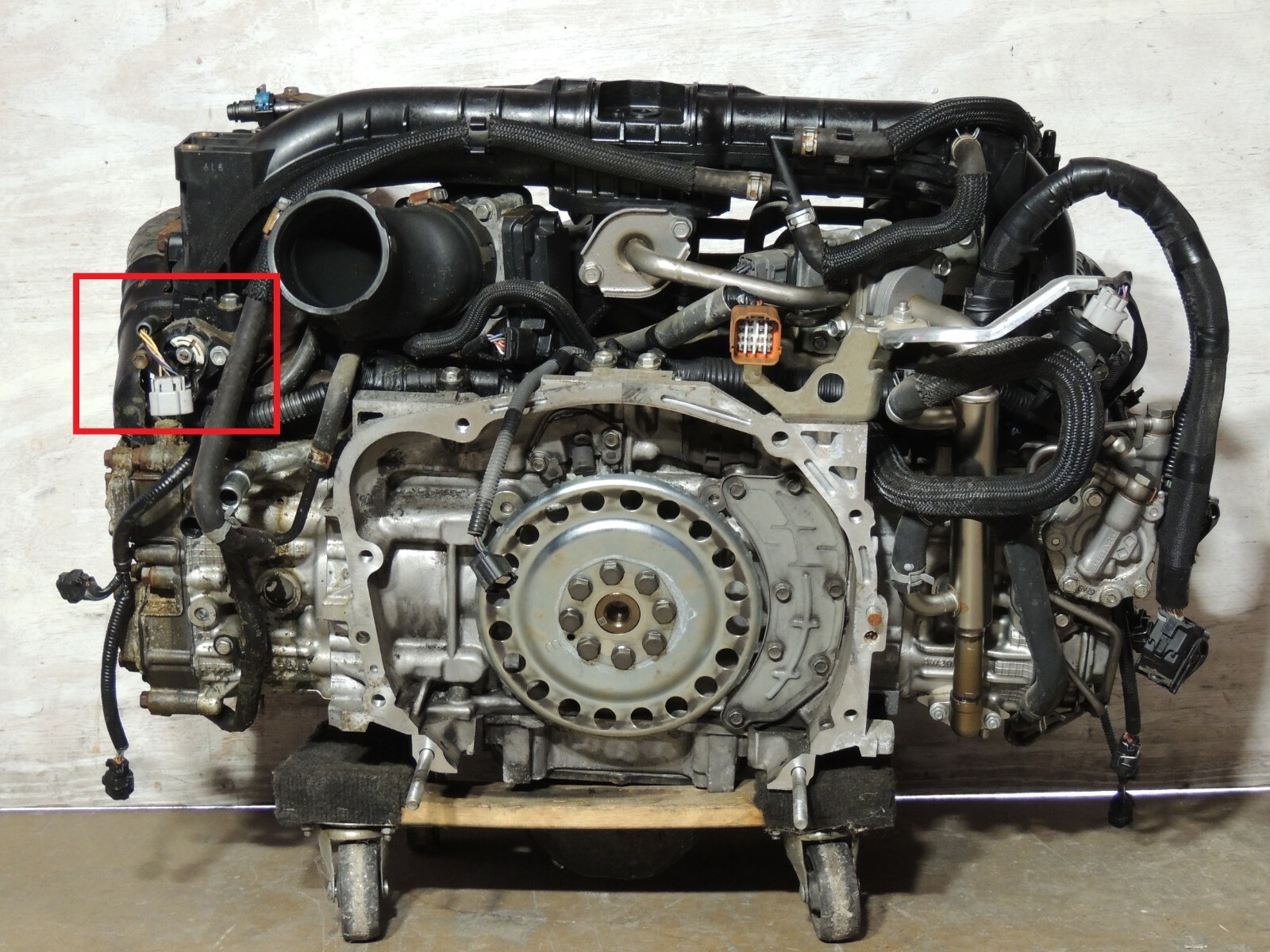

FA20F
FA24F
FA20D
They don't look the same to me.
