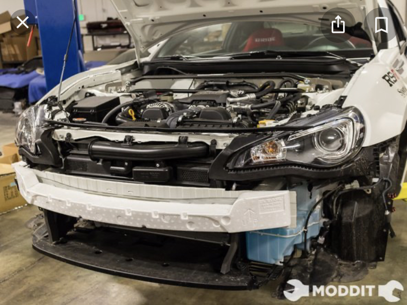

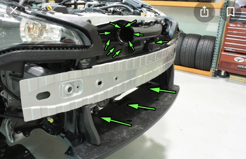

The problem with all those designs and factory “cai” is you have no airflow coming in from front bumper it’s just pulling whatever random stagnant air in that area. Front crash bar and foam block all air from that side so have small holes on the back of the plastic piece behind intake.
Beatrush bumper bar completely opens up all that airflow to be able to actually pickup moving cold air from the front end.

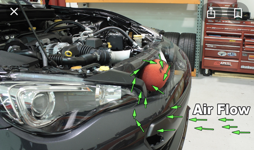

There are several air scoops available that solve this. Greddy pictured, AutoFactory, LegSport.. I can't say that it added any power even on the butt dyno. But the IAT we lower so thats nice.

That is done on purpose I believe. I may be wrong on this, but I think the intake does better drawing from a low pressure area (behind the bumper cover) than from a high pressure area (vent exposed to the front of the car).
I think even BMW switched it up from a ram air style intake to drawing from behind the bumper like our cars do.

Velocity through the filter is pretty low. Only way in increase that is with a pressure difference. Airflow has a dynamic pressure in addition to a static pressure. When you slow that airflow down (with the radiator) you transfer that dynamic pressure into greater static pressure, which in the twins is captured in the grill opening. That static pressure is reduced less by changes in flow direction than dynamic pressure, and also suffers from less turbulence. As such, using the static pressure from the grill opening is theoretically more efficient in producing clean, high pressure airflow than a direct duct to the front of the car.

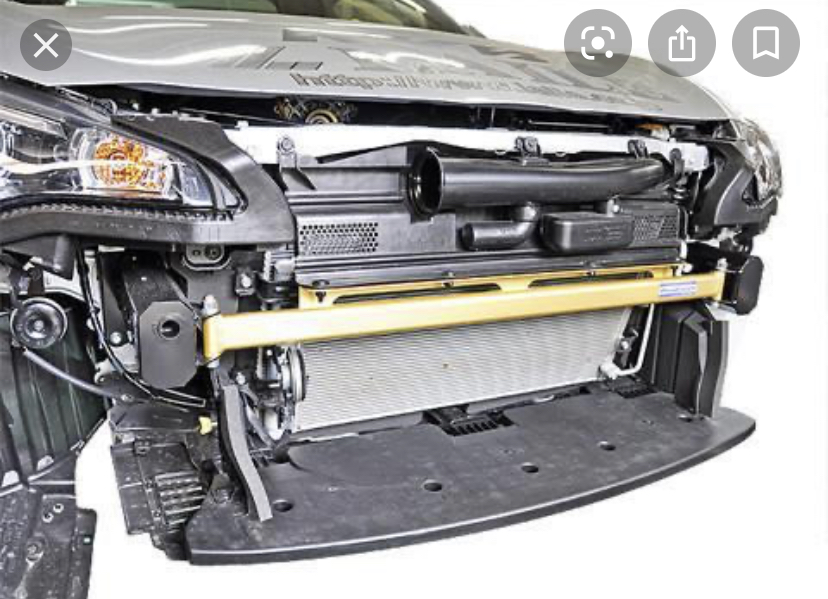

Oh! This just replaces the factory "snorkel" with a shorter piece and larger opening? I imagine it will change the sound but not have much more effect if you keep the intake baffle underneath it.
Do you think with something like this you could see a bit more effect?
