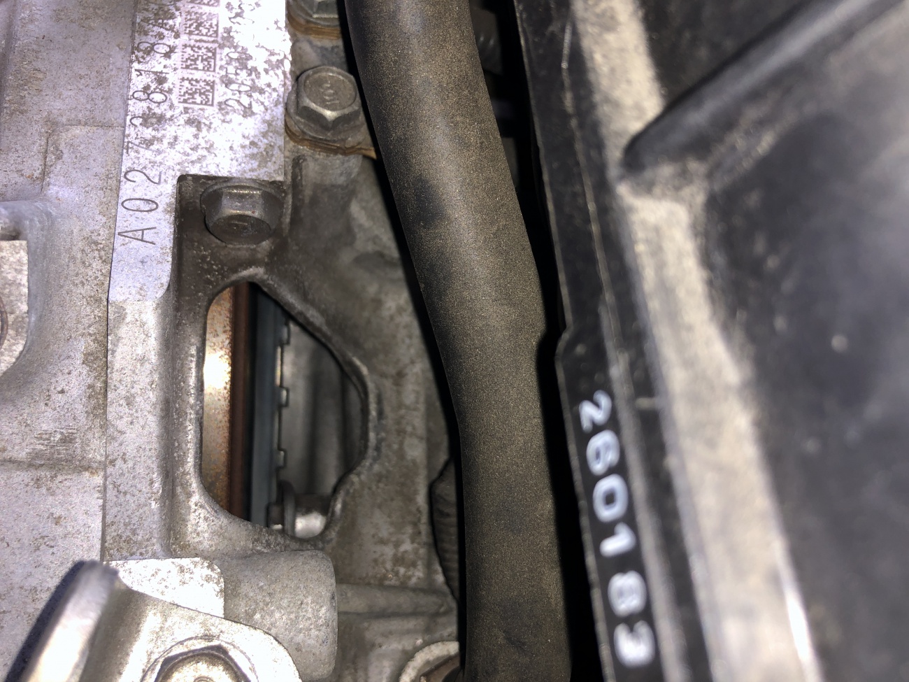

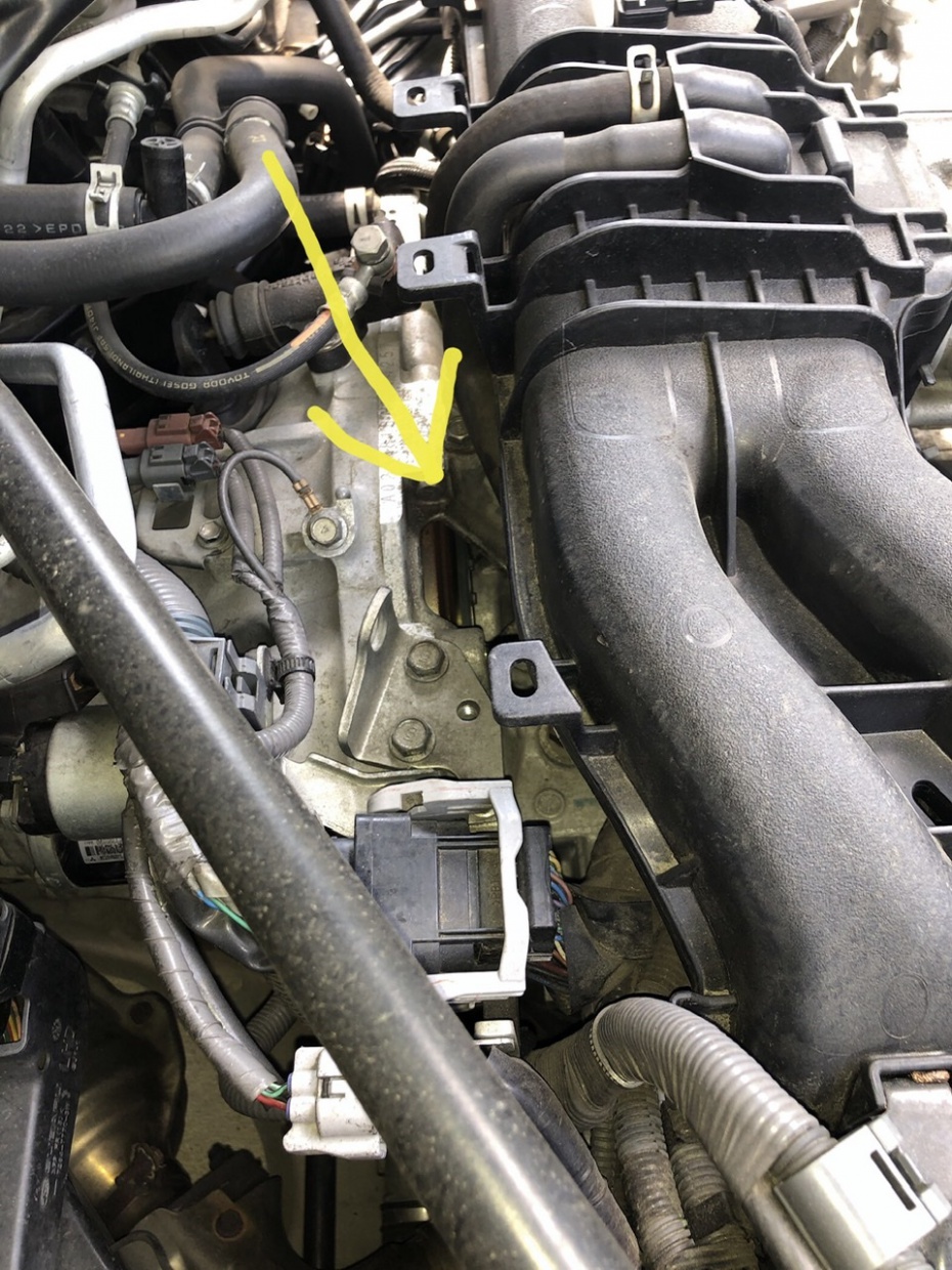

Hey guys, so I have a black plastic? piece missing from a part of the engine and I’m not sure what it is and if any problems could have arised from not having it on for a good amount of time?

Did you recover the plastic? If not it fell down inside there with the flywheel.
The part is just an inspection plate. Varus makes an aluminum on for $30corbthe original is $15 from the dealer.

It was a little while ago so I’m not 100% sure, but my faint memory feels like it might have been broken and I got some it? Not sure if some of it fell in, maybe some leaves could have fallen in there as well, not sure.
How bad would that be and could that have anything potentially to do with that rattling I described?
Could it be scoped or would the whole thing have to be taken apart?

It's not likely to be related. The flywheel would just pulverize anything plastic or leaf related. I would have to be able to hear the rattle to give you an idea.
The hole being there for a long time is not necessarily an issue. You might have some extra clutch dust built up in your engine bay because of it though.
Mine was open for a few months before I broke down and bought the varus part.
