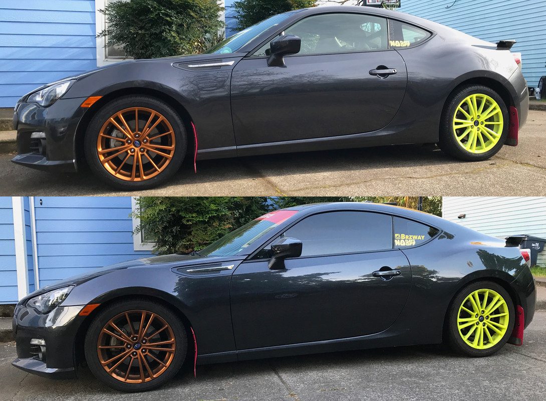

I just installed these. I can't really say much about them yet since I haven't really gotten to drive on them much. One of my end link nuts cross threaded so I am waiting on some new ones I bought from a forum member. So maybe in the future I could offer some better experience on them after I get things sorted out. Mainly I wanted to post up a photo of before and after so people could get a reference of the height change they offer.
The before picture was taken a couple months before. I just happened to have that photo.
Spring Specs From CSG:
Swift Spring - Spec-R Springs
Application: Subaru BRZ / Scion FRS
Spring Rate (Front): 4.4-kg/mm (245-lb/in)
Drop (Front): -28 mm (-1.1 in)
Spring Rate (Rear): 5.3-kg/mm (296-lb/in)
Drop (Rear): -25 mm (-1.0 in)

Nice drop, they may get slightly lower after they settle.
