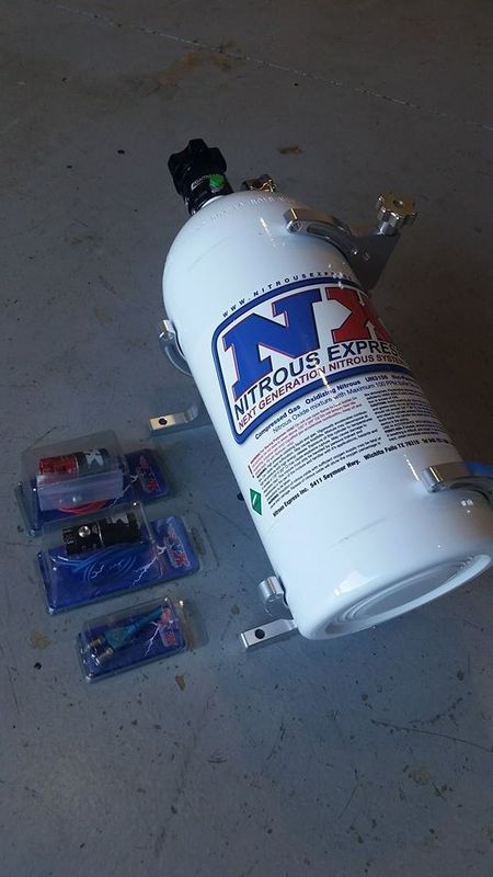

I have started to collect parts for my coming nitrous kit, I will be running a small 35-50 shot on top of the boost I am already running from my turbo.
The plan here is to be able to keep a street friendly sized turbo but have more on tap when need be.
I will be mounting a NX Shark nozzle in my intercooler pipe 6" before the throttle body and running a NX Maximizer 4 controller for all the fail safes in one easy program. I do have the NX Plate for the FA20 but after talking to NX they said going with a single nozzle is better for a small shot.
There wont be any dyno graphs real soon so dont get your hopes up but I just wanted to put it out there of another car hooking up a bottle!
For the F&F generation.
Fits pretty nicely, need to sort out a solid mounting point.
