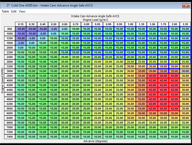

You can get that effect with the right AVCS and Ignition Advance timing. I'm usually trying to get rid of this effect, rather than trying to cause it. I usually end up just flogging it when it runs like that, because it's just depressing to try accelerating gradually when it has no power. The main reason I can't put up with it running like that is mileage though. It just sucks gas when it's flogged. Take a look at this table. It would run like you want it to.
