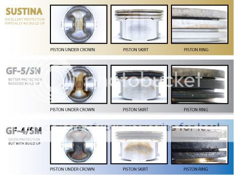

eneos 0w50
Is this oil to thick for track use? I was told it was ok but others has also told me it thick. Don't know what to think now

Eneos Sustina 0-50 has been in use for several years by BRZWORLD racers both D D'ng and on the track.
Very common in Japan also.
It is preferred due to higher oil pressure, heat resistance etc.
