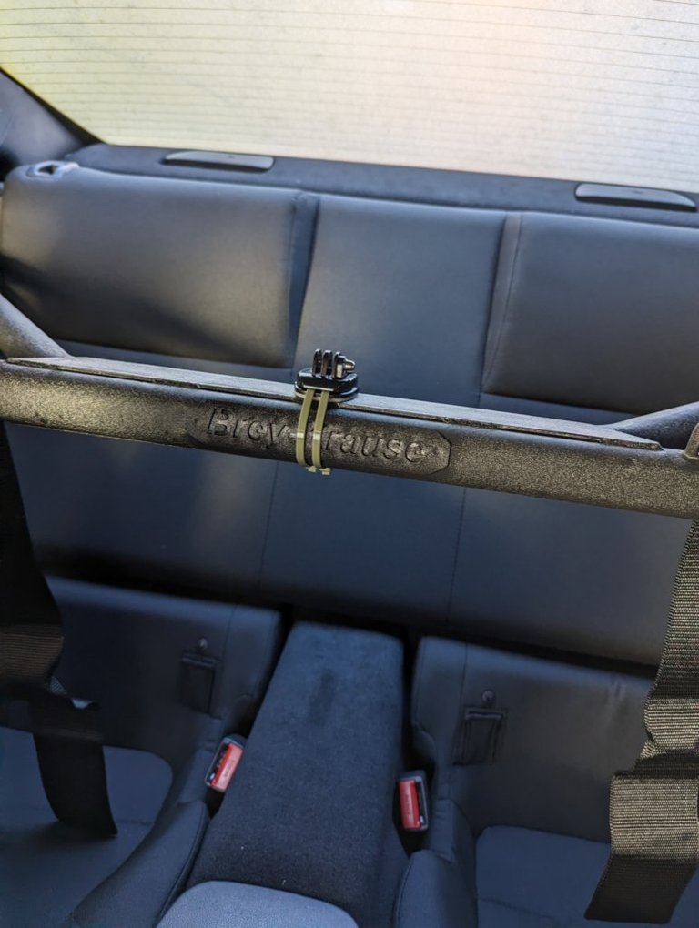

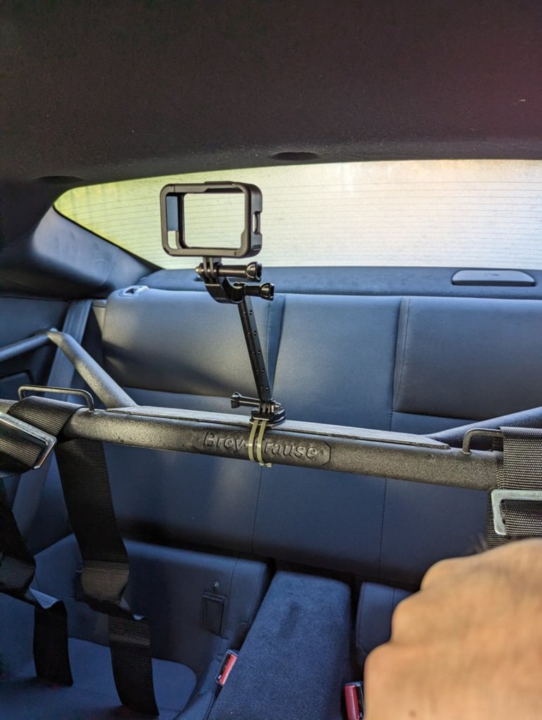

If you're using a harness bar like BK's for our cars, you will realize that the center section of the bar is too wide for any off-the-shelf bar mount to work. I ended up making a mount with little to no cost.
The key is to find appropriately sized zip ties that you can fit within the rails of the GoPro mount. I inserted one side of the top mount piece to its rail first, and then forced the other side.
Align your zip ties before you fully insert the top mount, since you won't get to move it once it's in.
Ready to install
You probably don't need to use the adhesive bottom, but why not; it would reduce vibrations and movements at least..
Done!
