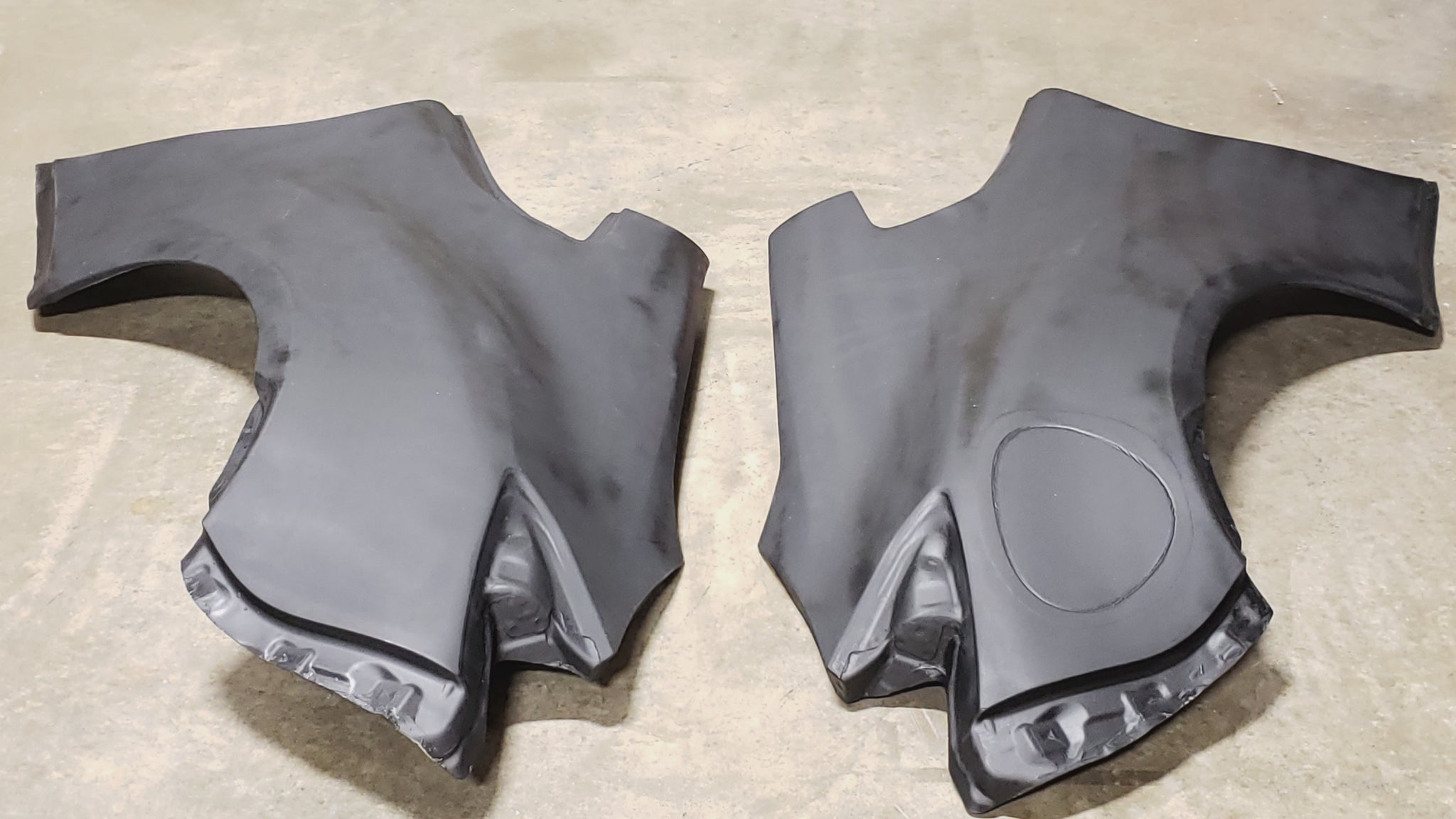

Looks like battle aero has FRP rear quarter panels that has me tempted.
I don't care for really any of their other stuff, but may save me a lot of time and money.
