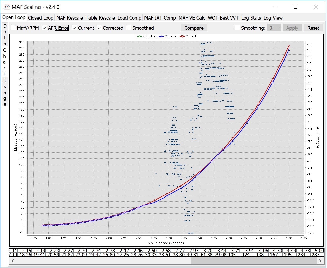

Hey folks, Im getting some strange AFR behavior during WOT pulls and hoping someone can help me out. Link below is a sample pull, but AFR shows the same for every pull for the last couple months, in all conditions. At least its consistent.
http://datazap.me/u/spuds/olsample2?....29&tmax=44.65
Mods: OFT Stage1 93 octane, Perrin inlet tube, nothing else worth noting.
In case its not obvious, Im referring to the sawtooth-like pattern in my actual AFR. Drops gradually, then resets around 4200 RPM, then starts dropping again. Im going nuts trying to figure out what is going on.
Has anyone seen this before? I imagine this isn't limited to my car, but its kind of hard to search for what someone else would call it. If the answers are on the forum somewhere, please send me in the right direction.
Are there any troubleshooting suggestions? I was thinking of logging .75% throttle pulls and seeing if the same thing happens as my next step, but not really sure what that would tell me.
Lastly, since Im pretty sure this will be the first suggestion, I could correct with MAF scaling, but take a look at what that would look like. My closed loop is exactly what is needs to be, so that part isn't changing. With that shape making no sense, it seems like there should be something else I can do to compensate.

Thanks for the suggestion. Ill be looking into that and the AVCS maps. I am thinking more along the lines of AVCS at the moment, as I am pretty sure the OFT tune messes with that quite in the 4K region a bit to correct the TQ dip. Now, the optimal way to compensate for it is the real question...
Im now looking at this thread (below). How I missed it originally, I have no clue. It looks like the same exact thing I am seeing and it looks like they got it sorted out.
http://www.ft86club.com/forums/showt...=115056&page=5
