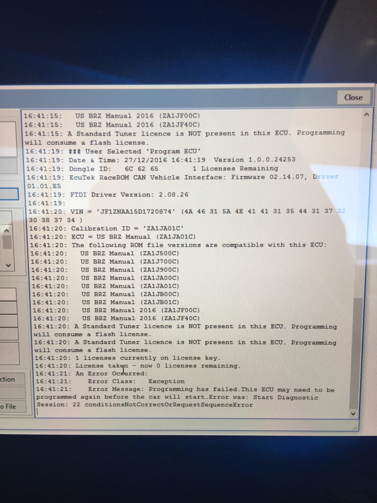

Trying to reflash my ecu after getting a new license. After applying license updates and updating the ecutek software I tried to program my ecu with a tune, an error occurred and stating
"Programming has failed. This ECU may need to be programmed again before the car will start. Error was: Start Diagnostic Session: 22 conditionNotCorrectOrRequestSequenceError"
After that error, it seems like I can't program my ecu without having to purchase another license. Has anyone seen this before?

Originally Posted by Kodename47 View Post
So it hasn't taken the licence? Any idea why it failed, knocked connection, plugging anything in while flashing or low battery?
What happens if you manually select the vehicle type and flash that way? That's the usual way to get around a failed flash, but obviously would require a license on the ECU.
My laptop battery was fully charged, nothing else was plugged in besides the dongle and the ecutek cable. I havn't tried manually selecting vehicle type.

I meant car battery rather than laptop.
If you plug in anything to the car like the 12v that can interrupt comms. That's a common cause of failure, as is a low battery. If you need a new license then you'll have to arrange that with your Master Tuner. However it's worth seeing if you can actually flash the car at all. Does it start/run?
