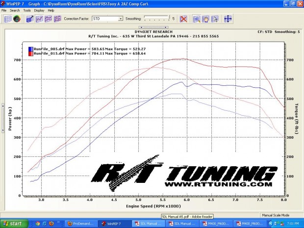

Another interesting dyno sheet. I am not understanding why you aren't getting peak torque as soon as the turbo hits max boost which should be in the 4000 to 4500 RPM range. Also it looks like the power was still increasing so why not rev it out to 7400 to 8000 RPM? Can we get a boost plot?
You are getting caught up with whats the "norm" for most dyno plots you see on other cars. Peak torque has more to do with characteristics of the engine and also gearing rather than when a turbo comes into full boost. This could also be Jr limited the way boost comes in to preserve the stock motor at these power levels. Im sure he will chime in here with an explanation and boost plot.
Look at the plots below, I searched others and could not find anything that suggests otherwise on these cars. Your car was turbo, by any chance do you have a dyno sheet that shows us what you are talking about exactly?
