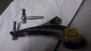

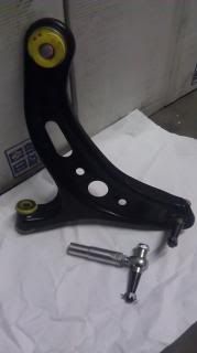

OK so I decided to try a track weekend with NASA in the TTD class.
then I looked closer at the rules and my front lower control arm solution to running the car 3" lower than stock with stock camber curves and roll center/bump steer was going to cost me EIGHT POINTS!!!!! Thats out of nineteen available!
SO I completed my adjustable PRESS IN to the STOCK lower control arm geometry solulution... ant only have to take FOUR points...for a less adjustable but work alike solution.
Add the Whiteline Front bushing and inboard bushing kits and you have 80% of the Robispec adjustable tubular solution (but still twice the weight).
this system has
Roll center adjustable correction
Bump Steer correction
added castor
added antidive
What it doesnt have of my full tubular solution is
Track width adjustment
Camber adjustment (as part of above)
Precision of full metal Spherical bearings.
This an all under 350.00 (whiteline parts NOT included)
This is a simple PRESS IN MODIFICATION!
leave the stock bushings in place and you will not even increase your NVH!
Picts

Robi,
Whats your points set up look like right now?
GTM_Challenge is offline   Reply With Quote
Old 04-04-2013, 02:56 AM   #8
robispec
Drives: Black frs project
Location: Socal
Posts: 960
Thanks: 189
Thanked 886 Times in 381 Posts
Mentioned: 190 Post(s)
Intake+1
Full exhaust +5
Fuel pump(e-85) +2
dive angle/ball joint mod +2
Bump steer mod +2
Suspension dampers/springs+5
Tires +0
Weight +0
Brakes +2
so 19 total....
Trying a inovative tire solution...lol
205 Hossier R6 -10 Points for size reduction +10 points for the tire...= ZERO tire mod points ;-)! (now lets see if my chassis tuning trickery can make the little sticky skinnies work!)
What is your spin on the points?
robispec is offline   Reply With Quote
