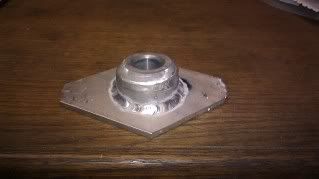

we are slightly narower rear track and 1.5" wider front track than stock. Front roll center is corrected (to allow the rear to transfer weight faster) and front tierods bump steer corrected for the drop and the tubular front lower control arms.
-3.5 front camber and full bump travel front and rear.
one of the parts that helps this
the car is slightly loose under trailbraking or off throttle turn, in mid throttle gets you to neutral/slightly tight, off throttle to full throttle at apex yields barely loose corner off caught if nessisary (usually the torque loss with RPM increase does this) with a light twitch of the steering wheel we will probably soften the front spring one step to give the car a bit more front bite turn in to mid corner.
so yes You are correct
we have done more than swapped springs on installed coilovers. ;-).
