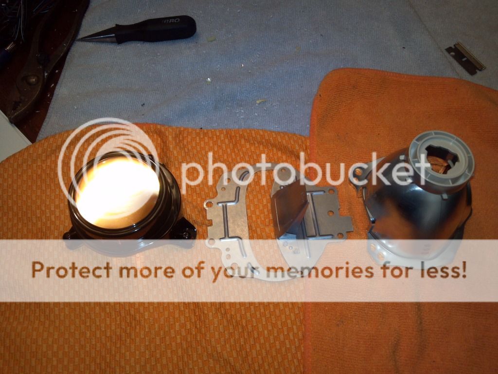

Once housing is "halved"

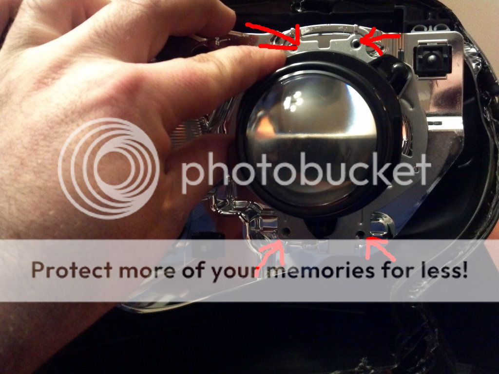

Remove projector housing 4 phillips screws:
Seperate projector housing 3 phillips screws:

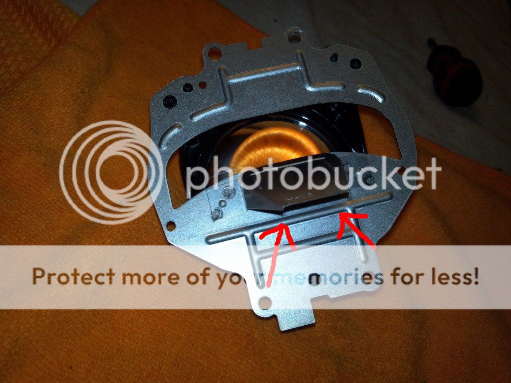

For painted version, paint cutoff shield (middle of picture) desired color and re-assemble from this point.
LED will sit under this "Shield"

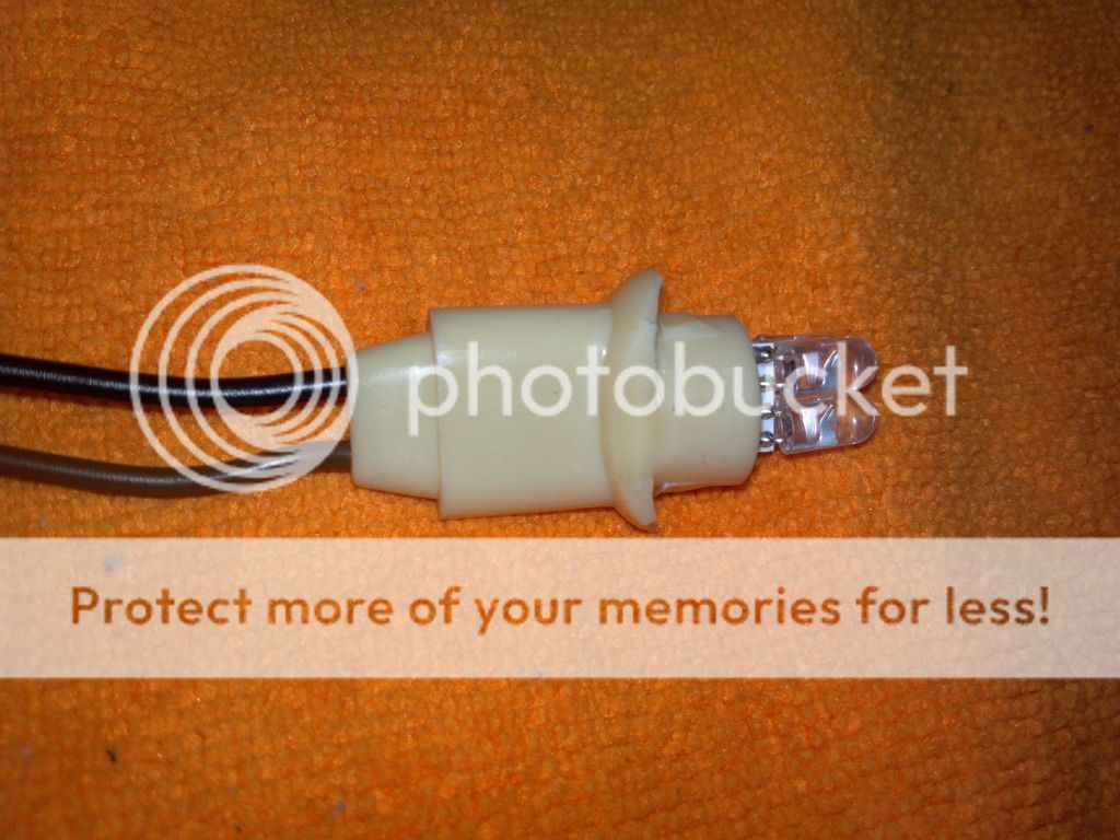

I used a 194 holder and 194 style red LED bulb:

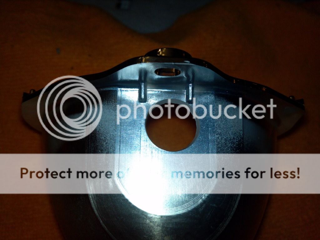

Figure where to drill and get as close to edge of proector as possible:
Mine came out a little off center, drill slowly using good sharp bits, small pilot hole and then whatever
size you may need for your perticular lighting socket:
Trim light socket to fit better, I made one edge straight so I can get it as close as possible
to the edge of the housing:

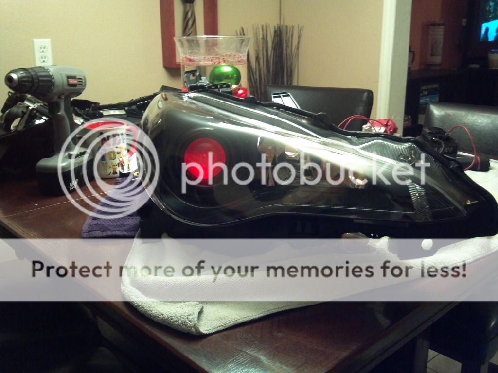

Install LED into socket and install socket into housing. re-asseble projector housing (lens,
cutoff, reflector, 3 phillips screws) and make sure to test that it works as desired before
install into housing and re-baking everything together this 14.4V drill battery is perfect as
that is close to full charging voltage with vehicle running:

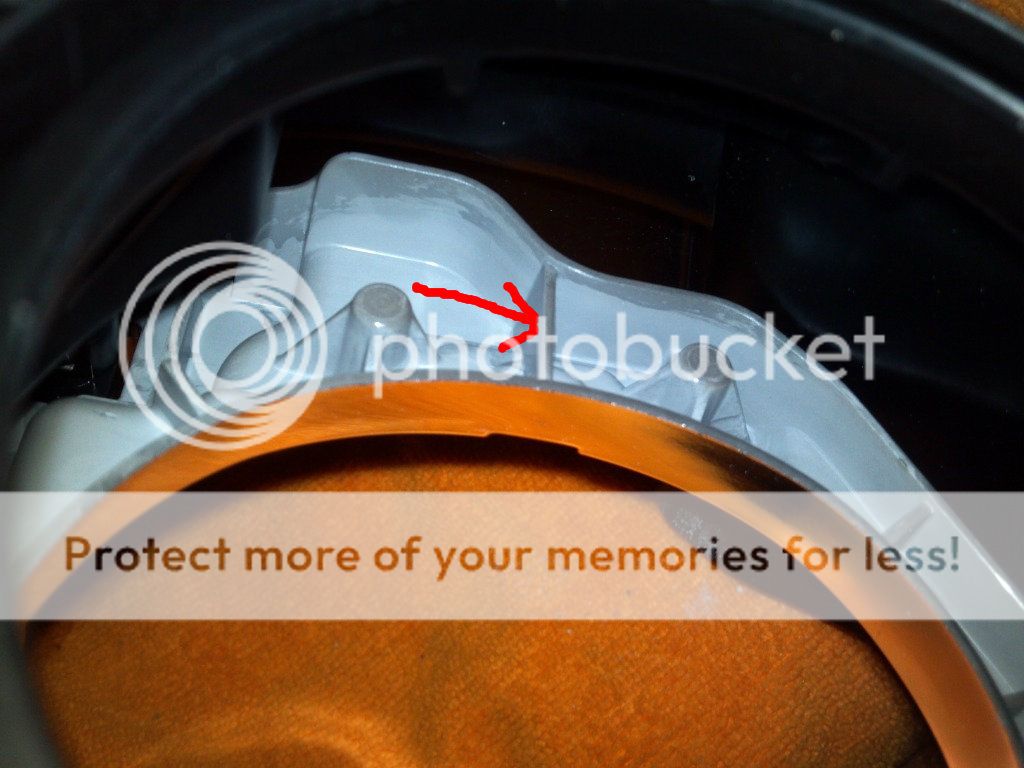

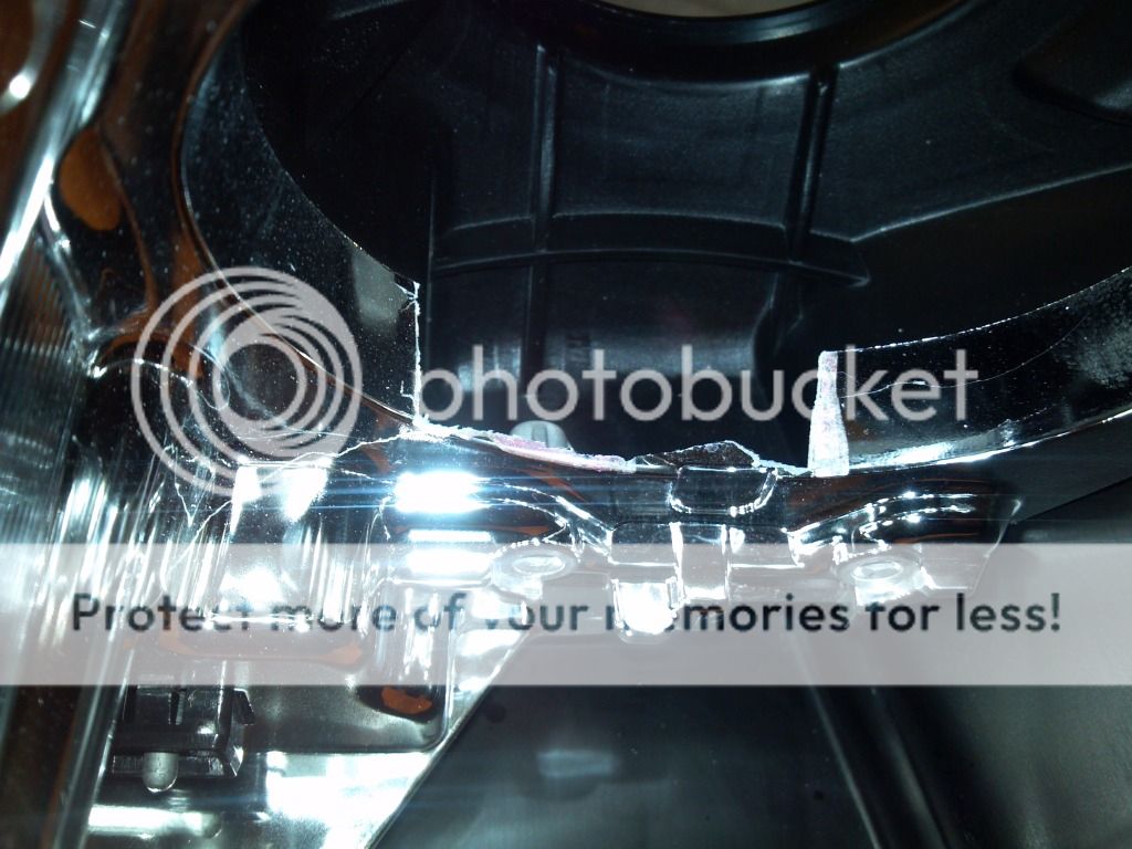

Now You need to trim some of the main housing to get light socket to fit I used a new pair of
side cutters, after doing this I would recommend a dremel here as this material is brittle and
cracks easy with the use of cutters. you also have to trim some to the side so you can twist
the light in to place use some judgement here and remove what you feel is neccessary for what
you need:

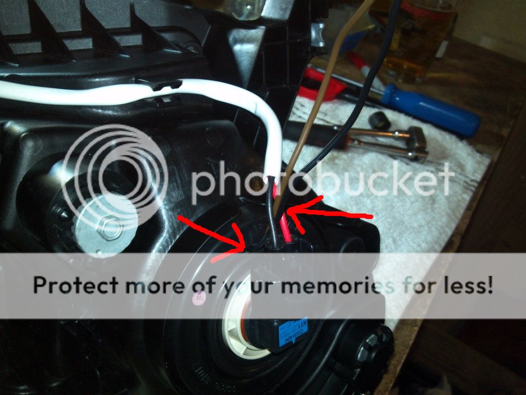

Re-install projector housing with newly installed LED socket into the light half. run wires
out through the rear opening. make a small hole in light seal and thread wires though (you
can add a dab of sealant here if you so desire). I ran mine in between the headlight wiring
to keep everything nice and neat:

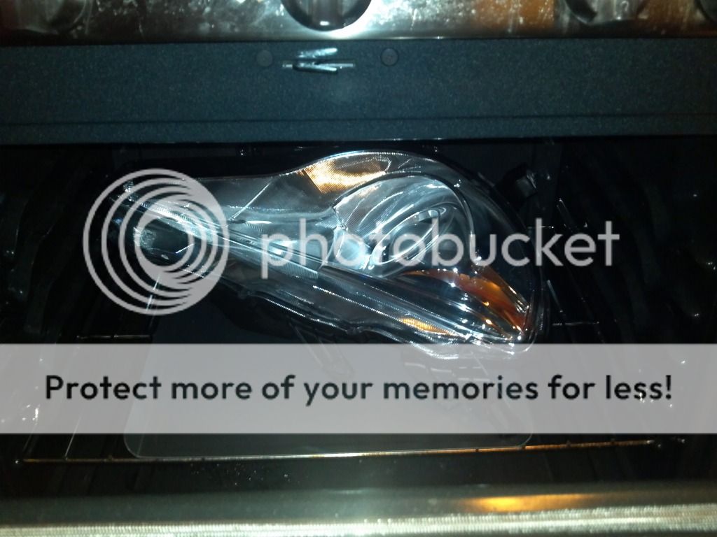

I put the two halves together as far as I could before re-baking. Then once baked I squished
them together further and re-assembled, make sure to re-test operation of LED before you
re-install into vehicle. better to catch a problem here than to have an issue after
re-installing the front clip:

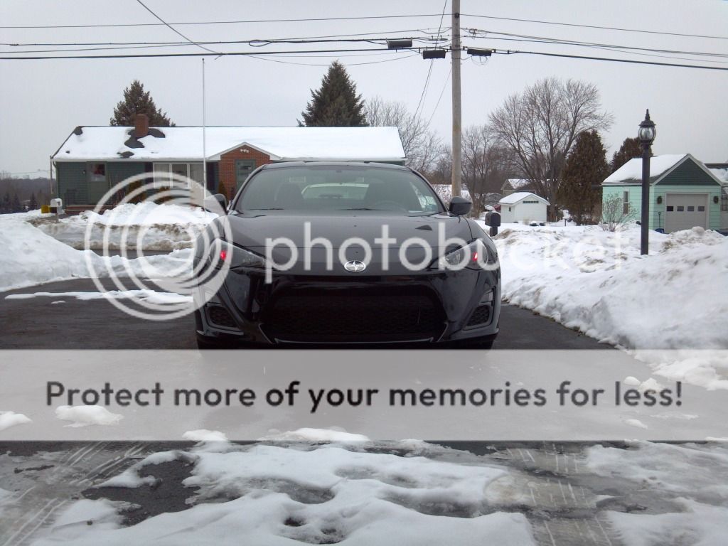

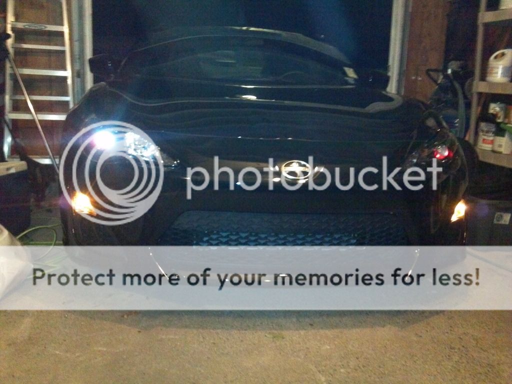

Install headlights into vehicle and wire LED's to Your desire there are many options here. I ran
mine to a seperate switch and I can turn them on or off as desired here are some pics, No Daytime
pics Yet, will put up soon when we get nice weather, vehicle is in garage for winter. In the last
picture I had headlights on and unplugged the Dr. side so you can see the LEDS effect on headlight
output. there is a slight hint of red when looking at the light but none from drivers seat
looking out:
