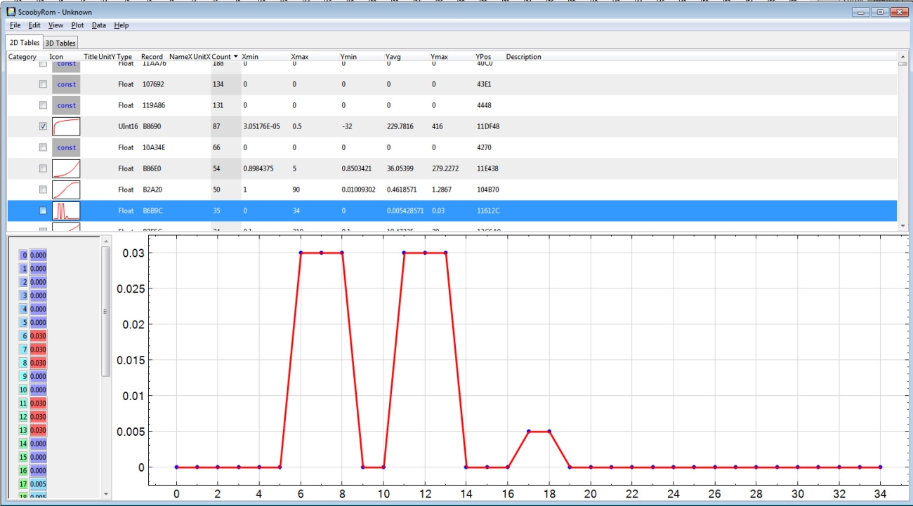

Following @Td-d's work on the ROMraider forums here:
http://www.romraider.com/forum/viewt...hp?f=40&t=8615
I had a look at the A01G ROM with ScoobyROM.
Knock sensor calibration table was easy to find using Td-d's ScoobyROM method, unpicking the knock control logic is quite difficult. There is also a table that looks like it uses FLKC table offset as an input - possibly a threshold. All highly experimental.
Welcome any input into deciphering the knock logic.

    <table name="Knock Threshold" storageaddress="11612C">
      <table type="Y Axis" storageaddress="1160A0" />
    </table>

    <table type="2D" name="Knock Threshold" category="Ignition Timing - Knock Control" storagetype="float" endian="little" sizey="35" userlevel="5">
      <scaling units="ECU value" expression="x" to_byte="x" format="0.0000" fineincrement=".5" coarseincrement="10" />
      <table type="Y Axis" name="FLKC Offset" storagetype="float" endian="little">
        <scaling units="Offset" expression="x" to_byte="x" format="0" fineincrement="1" coarseincrement="1" />
      </table>
      <description>?? Knock threshold by FLKC offset </description>
    </table>

Originally Posted by Kodename47 View Post
How does the lower one work?
No real idea, but the value that gets passed to the 2D table is the FLKC cell offset - this reads 0-4 in the first RPM range as load increases, then 5-9 in the next RPM range... 35 values in all for 5 load ranges and 7 RPM ranges.
I played around with reformatting the table to the following, which makes me suspect that this is a table defining knock threshold or sensitivity per FLKC cell. The logic is very complex and I am nowhere close to unravelling it:

Aha, I recognize that memory address, I've been looking into this previously.
S10C/FFF815E0, K00G/FFF810B4 - there are 35 pairs of (A, B) floats, stored in the order A1 B1 A2 B2 A3 B3 etc. The FLKC values you see in datalogs derive from the A-side.
Yes, the ECU RAM is kept alive by the battery, which is why pulling the battery or fuse resets the ECU. There's an EEPROM storing VVT learned values, which I want to look into more someday.
(Also: S10C/FFF816F8 is the start of a series of unsigned shorts that is storing what is likely FLKC counters of some sort. That's where my research left off, so I don't have any details for this yet.)
