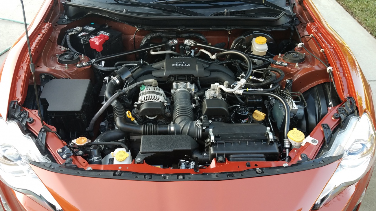

Project 4 - Arrived on 2/21/2019:
2013 FR-S - Hot Lava - 6AT, 74k, Raceseng Front Camber Plates, Motegi Racing 17"x8" Wheels, Catback exhaust.
Damage: Rear ended pickup truck.
After Inspection needs: Hood, both fenders, bumper cover, front crash beam (got hitch ball), both headlights, radiator, condenser, both front airbags, upper core support structure, both front seatbelts, windshield, front timing cover reseal.
Runs & Drives
Disassembly
Fuse Box repair...and some sweet camber plates...
New core support mockup

Project 4 - Update 1
Front end measured and squared. Both Upper Core Supports and Drivers fender brace replaced & ready for paint.
Dashboard removed for replacement and new airbags.
Both front seatbelts and airbag control module removed and sent to www.MyAirBags.com for repair.
Late night Friday work
Engine Reassembly on Saturday
New Radiator, A/C Condenser and Air Box components

Project 4 - Update 2
Been slow to update the progress, but much has been done!
Radiator air flow bits installed.
Under-panels installed.
Airbags replaced and dash reassembled.
