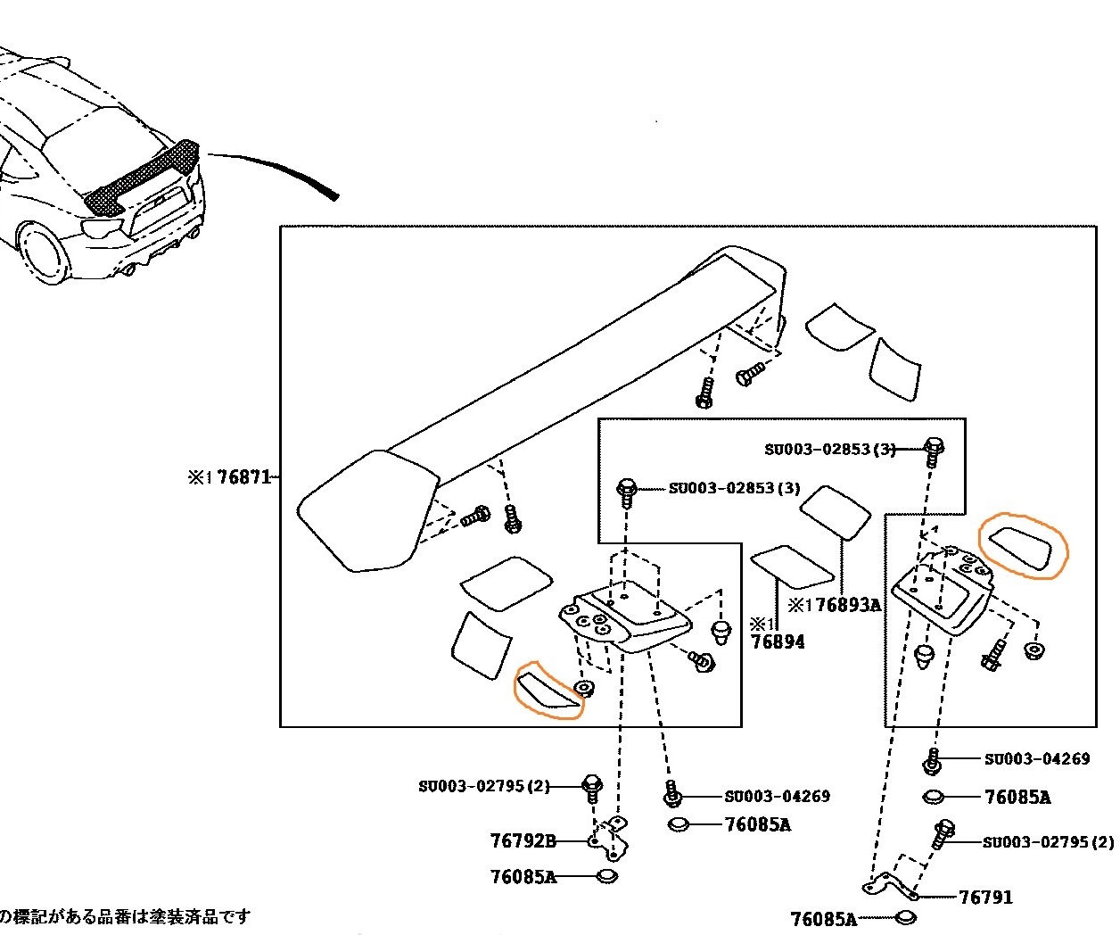

Sorry for bumping really old thread but I have question regarding Rear Wing Aeropackage (it's called Nur Spec Wing ?)
I lost some plastic cover but it seems it doesn't have part numbers on it
here's the picture showing the plastic cover missing :

Any luck?
