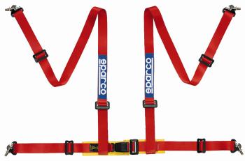

If you are really set on using a harness for your car without the roll bar and aftermarket seats, you could look into something like this:
http://jbautosports.com/sparco/sparc...n/g-51280.aspx
I see autocrossers and track day drivers utilizing this setup alot. Although, I would not recommend it for use on the street.

I look at that 4-point, looks like an easy setup.
